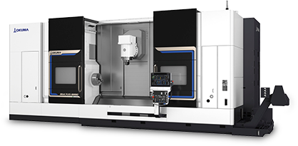

Completing machining of large gear components with one machine
The number of component loading/unloading and transportation between processes is reduced through process integration
  • A sub-spindle is used to complete processes 1 and 2 on one machine
  • The number of times that parts are loaded/unloaded and transported between processes is minimized. This reduces labor and chucking errors between processes.

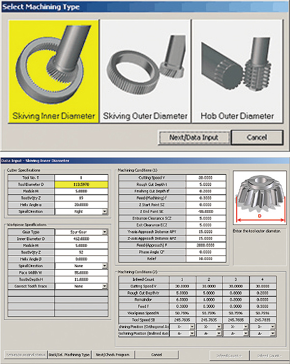

The skiving process is performed with easy programming
  • The Gear Machining Package enables high-accuracy gear machining by simply inputting specification information of gear
