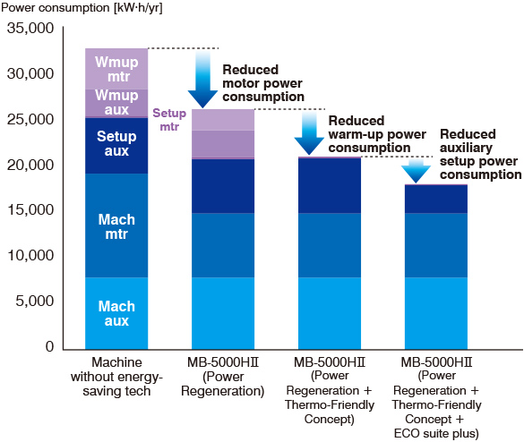

A system for an energy-saving societyECO suite plus
Next-Generation Energy-Saving System
The "ECO suite plus" retains the concept of achieving both high machining accuracy stability and energy savings (less carbon dioxide emissions) achieved by the Thermo-Friendly Concept and the "ECO suite" that was put into practical use in 2014. It is an energy-saving system with enhanced high-accuracy/-productive functionality and advanced eco-friendly support.
45% less
carbon dioxide emissionsby using Power Regeneration,
for cold starts, and ECO suite plus
45% less carbon dioxide emissions by using Power Regeneration, Thermo-Friendly Concept for cold starts, and ECO suite plus
[Calculations]
MB-5000HⅡ 50% utilization (8 hr/da, 20 da/mo, 1 yr)
  • Assuming 50% of setup and standby time with ECO Idling Stop.
  • Workpiece : Aluminum casing
  • Average load : 30% rating
  • Warm-up : 2 hr/da
Calculated from measured regenerative power

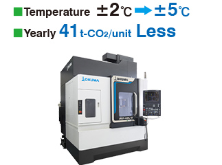

Temperature: ±2℃ ±5℃ Yearly: 41 t-CO2/unit Less
High accuracy stability even at 1/3 less air
conditioning electricity.

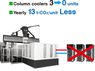

Column coolers: 3 0 units Yearly: 13 t-CO2/unit Less
Outstanding dimensional stability without machine coolers

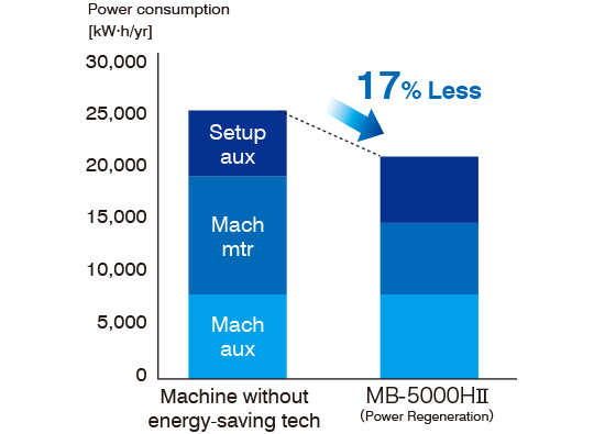

Power Regeneration System
Using regenerative power during deceleration eliminates energy wasteStandard on spindles and feed axes
Wasting no energy by regenerating decelerating power—previously discarded.
Power Regeneration System flow patterns
Power Regeneration System benefits
[Calculations]
Calculated from measured regenerated power

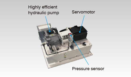

ECO Hydraulics (option)
Highly efficient hydraulic power pack reduces power consumption
Conventional hydraulic unit
MB-4000H actual data:
840 W
ECO Hydraulics
25min-1
260 W
[Pressurized]
Highly efficient hydraulic pump, Servomotor, Pressure sensor

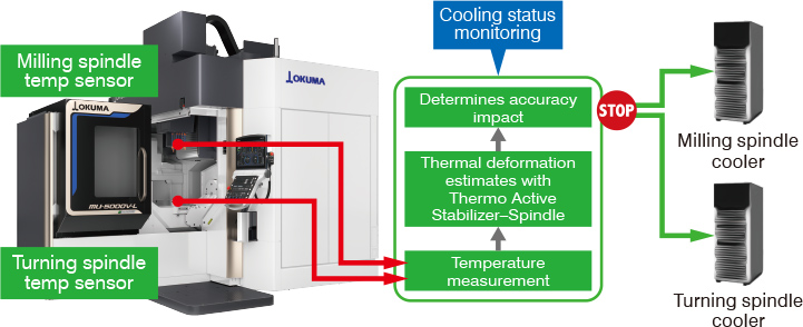

The machine monitors the cooling level when not machining,
and proactively turns off the cooler while maintaining high accuracy conditions.
The machine monitors the cooling level when not machining, and proactively turns off the cooler while maintaining high accuracy conditions.

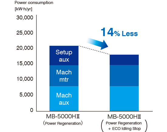

ECO Idling Stop energy savings
[Calculations]
  • Assuming 50% of setup and standby time used ECO Idling Stop.

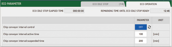

ECO Operation (option)
Peripheral equipment runs only when needed
By using only the required peripherals (chip conveyor, mist collector), energy-saving operations that also maintain high productivity are possible.
ECO suite plus enables more detailed tuning of operations to thoroughly support carbon dioxide emission reduction activities that do not reduce productivity.

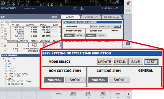

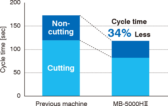

3Shortening cycle times
Cycle Time Reduction (easy setting)
Significantly shortens cycle times and reduces power consumption
Cycle times become much shorter by selecting the optimal parameter settings for the workpiece and machining operation all at once.
Previous machine→MB-5000HⅡ Cycle time 34% Less
[Measuring conditions]
Sample part program used to drill and tap dozens of holes on three sides of an aluminum die casting.

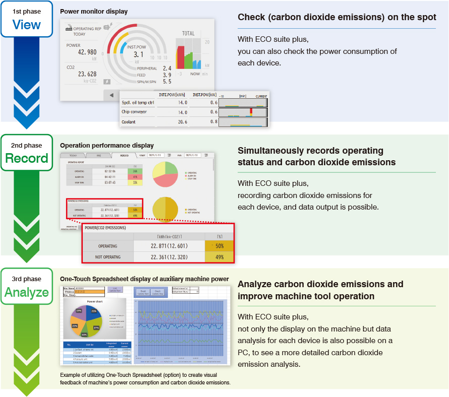

4Confirming and evaluating energy-saving efficiency
ECO Power Monitor
Evaluating energy savings and analyzing areas of reduced energy
Making it possible for the OSP control to analyze the operating status of each device.
ECO Power Monitor
