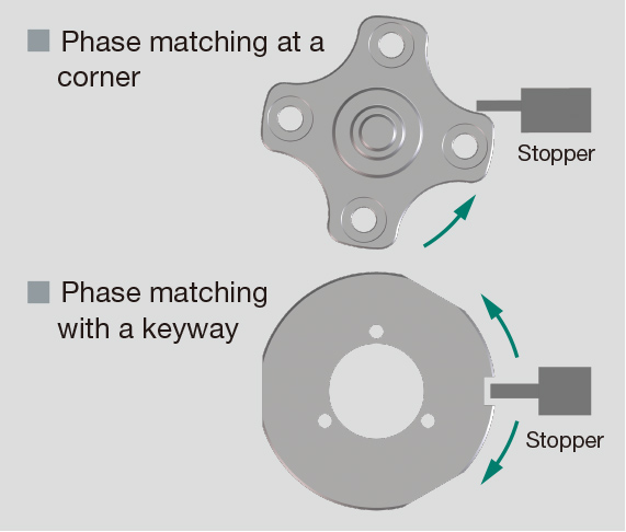

Here is how to get C-axis zero offsets: by mounting a stopper on the turret,
and having it contact a keyway or notch, to read the C-axis torque fluctuations.

Auto phase settings by the stopper contacting the cutting reference
C-axis zero offsets can be set in-machine by having the stopper contact the cutting reference. When a workpiece has a keyway, reciprocating CW/CCW rotation will index the C-axis zero offset position by the load on the C axis.
