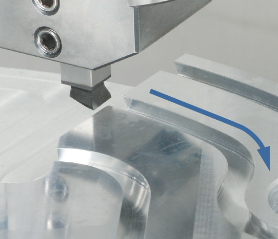

Controlled cutting edge angle per axis feed direction
When grooving complicated curves with a tool bit, the cutting edge angle must be controlled with the curving feed direction.
The spindle phase is precisely synchronized with cutting edge motion, to perform highly accurate grooving.
