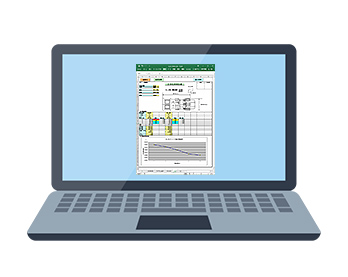

- Eliminate work mistakes by accessing OSP data directly from an Excel® spreadsheet.
- By sharing Excel created work procedures, other operators can do the same job.
- With the results of work done reflected in an Excel worksheet, the accumulated data can become a reference of accurate quality records.

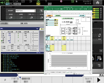

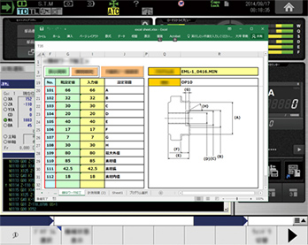

One-Touch Spreadsheet is one of the OSP-P300A options that allows you to set and refer to program selection, compensation and variable data, and other CNC operations from Excel spreadsheets in the OSP control.
With Excel spreadsheets, you can create dedicated apps that incorporate your machining know-how.
For work routines that varied per individual, now any operator can run the same job with shared Excel created work procedures.
Okuma's One-Touch Spread enhances DX (digital transformation) in the customer's factory and improves productivity.

										- Using the part program number as a variable input for the setup sheet eliminates repetitive reprogramming.
- With a program selection sheet that uses a code reader, any operator can easily call up the correct program.
									STEP1 Call up One-Touch Spreadsheet to input variables and select a program.
									STEP2 After inputting the drawing no. into the variable, scan the code with a code reader connected to the OSP control to automatically select the required program.
									STEP3 Start machining!

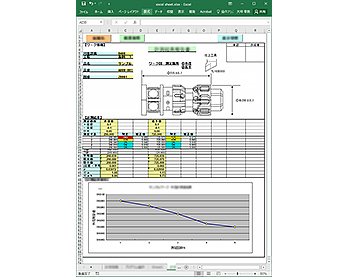

Use Case 2: Creating a machining test chart
- Problems
										- We want to keep workpiece measurement histories, but that's time consuming because inputs for the computer for each measurement is required.
- Incorrect numbers may be entered.
- Learning measurement methods and making test charts is required.
- One-Touch Spreadsheet Benefits
										- By creating worksheets to collect measurements, their histories can be maintained error-free.
- Since the data are in Excel worksheets, they can be easily graphed and saved as machining test charts.
- By describing the measurement procedure in a spreadsheet, any operator can perform the same operation.
									STEP1 Call up the measurement worksheet and perform the measuring procedure as described.
									STEP2 Read the measurement into the measuring worksheet.
 A test chart will be generated automatically.
									STEP3 The measurement worksheet of the test chart can be stored in the OSP control or in the office.
