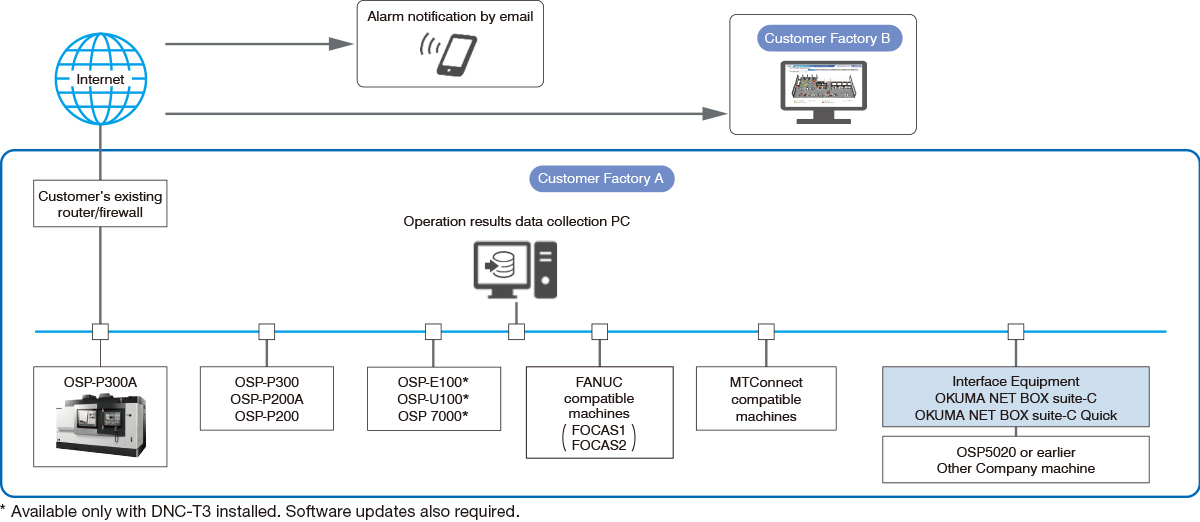

- Okuma’s Connect Plan with Internet access lets you see the operating status of a distant factory. You can check the operating status of a factory remotely, and check email notification of machine alarms.

Compatible Controllers
●:Available ○:Partially available -:Not available
| Functions | OSP-P300A OSP-P300*1 (Smart IF) |
OSP-P300*2 OSP-P200A OSP-P200 (Smart IF) |
OSP-E100 OSP-U100 OSP7000 (DNC-T3) |
FANUC compatible machines*3 (FOCAS1) (FOCAS2) |
Non-Okuma Machine Controls*4 (MT Connect) |
OSP5020 or earlier Other Co. Control |

*1. With OSP suite
*2. Without OSP suite
*3. Okuma machines with FANUC control; for Okuma and Okuma & Howa machines shipped after 2004. FANUC 0i (FANUC 0i-TD, 0i-MD) controls, however, are compatible from 2012 or later. For FANUC-equipped machines made by other companies, confirmation of connections and other retrievable items will be required on each occasion. Some items may not display on device screens depending on the type of machine, control system model, and software version.
*4. It will be necessary to confirm connections and retrievable items on each occasion.
*5. Grinding machines excluded.
