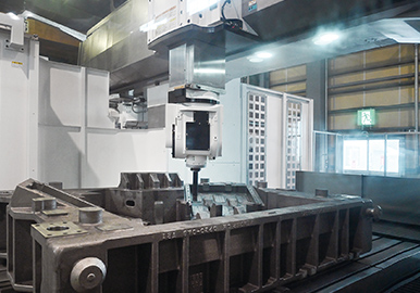

Hand-finishing process Reduced by about 20%
Surface quality was improved substantially with high-accuracy 5-face machining, which dramatically reduced man-hours for filing during the finishing work in post-process. The machine makes an especially great contribution to increases in productivity in the production of large outer parts of automobiles.
Reduction of man-hours for alignment and machine downtime
Precision measurement and alignment for large machine require attaching and detaching of workpieces, and required the manufacturer to undertake this part of the process. However, this process can be skipped thanks to MCR-BⅤ's intelligent technology and the automatic compensation function, which significantly reduces machine downtime.
