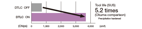

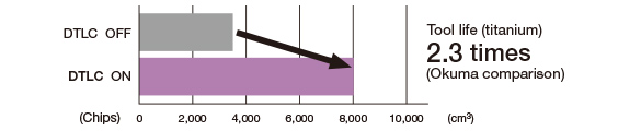

Reduced tool cost and improved tool life
[Actual results] Stock removal per tool under the same cutting conditions (tool life)
![[Actual results] Stock removal per tool under the same cutting conditions (tool life) Tool life (titanium) 2.3 times (Okuma comparison)](/english/solution/images/synchro/p_synchro01.jpg)
![[Actual results] Stock removal per tool under the same cutting conditions (tool life) Tool life (SUS) 5.2 times (Okuma comparison)](/english/solution/images/synchro/p_synchro02.jpg)

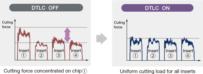

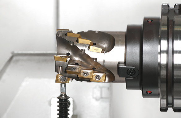

Optimizing feed rate according to insert-tipped tool runouts
When machining difficult-to-cut materials, the slight shortage in swing from an insert will cause other inserts to receive more cutting force and become chipped.
With Dynamic Tool Load Control, the swing for each insert is measured to optimize feed rate relative to the tool runout.
By equalizing the cutting forces, chipping is reduced and tool life is improved. Cutting conditions don't have to be lowered and expensive solid tools don't have to be purchased.
Depending on the tool runout, the feed rate can be controlled to equalize the cutting force among all the inserts.
