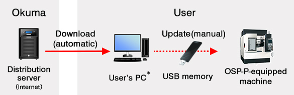

Pattern file update methods
On the OSP display screen, users can switch between two pattern file update methods.
Pattern file update licenses are valid for three years.
Online update
Updates through direct connection to distribution server managed by Okuma.
This option can be used for machines that can be connected to the Internet.
								Offline update
Updates through the user’s PC or USB memory.
This option can be used for machines not connected to a LAN or closed LAN.
