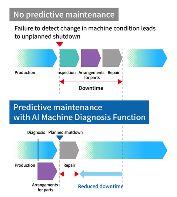

OSP-AI self-diagnosis technology for machine tools makes possible failure prediction diagnosis of machine elements and self-diagnosis of drilling conditions.
Achieve stable operation by using AI (artificial intelligence)
Minimize downtime with early detection of machine damage

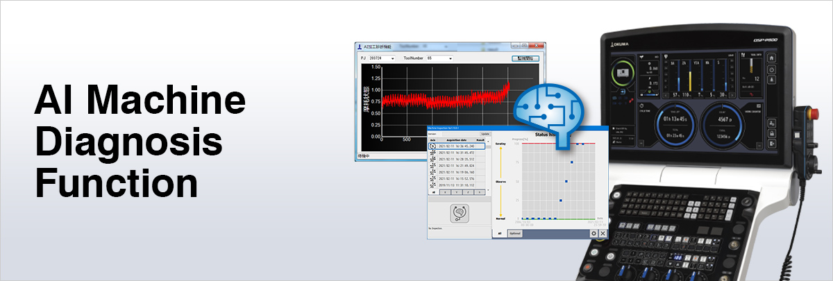

AI Machine Diagnosis Function
Self-diagnosis of machine operating conditions
The AI installed in the OSP diagnoses the presence or absence of abnormalities in the spindle and feed axes of the machine and identifies other malfunctions. You can minimize downtime due to machine outages and maintain stable productivity for a long period of time.
The fusion of machine and control technologies eliminates the need for measuring instruments and easy operation can be performed with the push of a button.

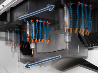

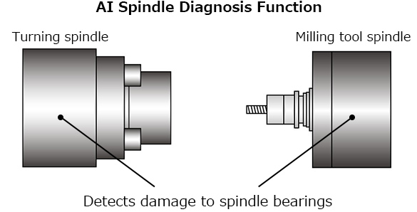

Early detection of spindle and feed axis malfunctions
AI Spindle Diagnosis Function

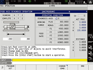

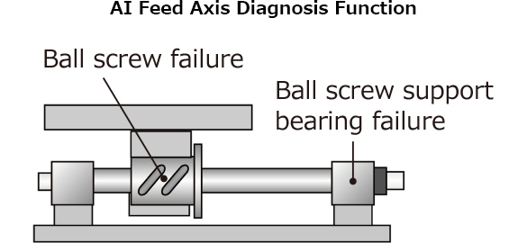

AI Feed Axis Diagnosis Function
* AbsoScale specs are required for diagnosing ball screw defects.

  1. STEP1
    Start & follow guidance screens
  2. STEP2
    Execute diagnostic operation and acquire data

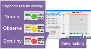

  3. STEP3
    Diagnosis
    Diagnosis
    Easy-to-understand results displayed
