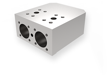

Manifold block
Manifold block
Hydraulic control component | Hydraulic valve component
Material: S25C

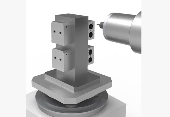

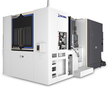

Performing multiple machining processes efficiently with one machining center
Non-cutting time during parts loading/unloading is reduced
  • Multiple parts for processes 1 and 2 are attached to improve productivity
  • Workpiece loading/unloading can be done outside the machine using the automatic pallet changer (APC), improving the operating rate of the machine
Attaching multiple parts for processes 1 and 2

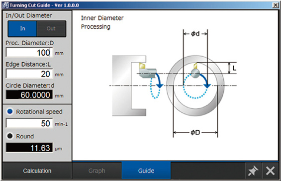

Process integration of turning with Turn-Cut
  • Spool holes with steps are machined using a single tool
  • The required spindle speed and circularity is easily calculated by simply entering the machining diameter and tool information into the Turn-Cut application
Turn-Cut app
Turn-Cut app
