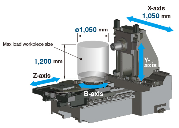

Optimal travels for the large parts applications
Higher floor space productivity with larger work envelope
Work envelope
X-axis travel: 1,050 mm (longer than previous machine)
Y-axis travel: 900 mm
Z-axis travel: 1,000 mm
Max load workpiece size
ø1,050 × 1,200 mm*1, *2 (larger than previous machine)
*1. Standard 2-pallet APC only
*2. From pallet top to 120 mm up, max workpiece diameter is ø1,000 mm
Max tool length
630 mm*3 (option) (longer than previous machine)
*3. Chain magazine only

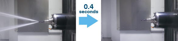

Shorter tool change times are possible when using thru-spindle coolant
- Suction of excess coolant in spindle
Removes residual coolant in the tool and spindle in one draw: 0.4 seconds *1 (drill actual data). In-spindle coolant suction eliminates the need for an air blow (minimum 15 seconds) to remove residual coolant, shortening tool change time.
*1. Coolant suction time varies depending on the tool.

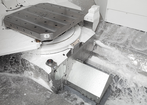

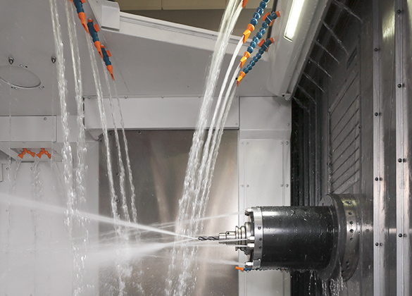

Chip discharge that maximizes uptime
With simple workspace covering and reinforced coolant applications,
Just Z-axis travel single cover and a smooth X-,Y-axis telescopic covers suppress chip accumulation.
Moreover, in dry machining without coolant, washing only the lower workspace area with coolant is possible.
In-machine washing prevents likely areas of chip accumulation, by cleaning away chips to maintain long-run production runs.
Chip discharge and workspace area designed to prevent chip accumulation
In-machine wash coolant: 450 L/min (18% improvement compared to previous machine)
Stronger workspace lower area wash and hinge conveyor smoothly removes large-volume coolant and accumulated chips out of the machine.
From the upper area of the workspace, a shower coolant system (option) and coolant from the X-,Y-axis telescopic covers suppress chip accumulation.

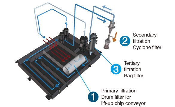

“Sludgeless Tank” enhances stable operations (recommended option)
Suppresses sludge accumulation in the coolant tank.
Dramatically reducing troublesome tank cleaning work
It is important to remove impurities (sludge) contained in the coolant for stable operation of the machine, and coolant tank cleaning is indispensable. The Sludgeless Tank (recommended option) efficiently collects 99% of the amount of sludge and reduces coolant contaminants. By suppressing sludge accumulation in the tank, the frequency of troublesome tank cleaning can also be drastically reduced, enabling stable operations over long runs.
