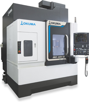

Process-intensive machining on a vertical machining center

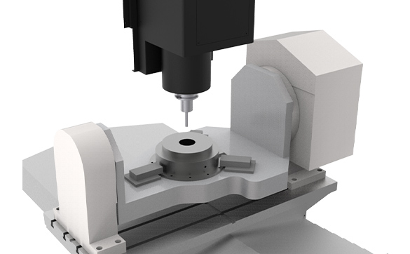

- Using an additional 1-axis rotary table, process-intensive machining for a workpiece that requires multi-side machining can be done without chuck change
- Multi-sided machining without chuck change is performed using a compact vertical machining center equipped with an additional 1-axis rotary table
- Transportation and setup change processes are reduced
- Since the workpiece is tilted, chips can be discharged smoothly during shower washing

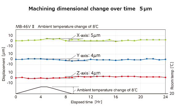

- Thermo-Friendly Concept enables the machine to autonomously maintain high accuracy and to achieve dimensional stability during long runs of machining (MB-46V Ⅱ)
- Machining dimensional change over time is maintained within 5μm (Room temperature change of 8℃)
- Factory equipment costs and power consumption can be reduced, since there is no need for a temperature-controlled room to keep constant room temperature
- FANUC controller is also available (MILLAC 468V Ⅱ)
