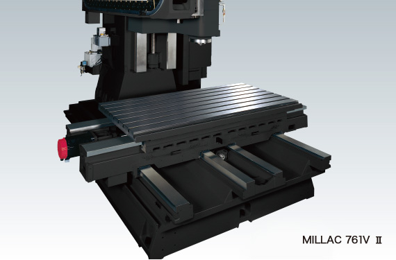

Reliable, highly rigid construction allows for high-speed, heavy-duty cutting
- Bed column
- Strong base column construction has optimally-placed ribs to counter chatter and twisting during heavy-duty cutting.
Traditional box ways is used for all axes to give high accuracy and rigidity over the long term. -

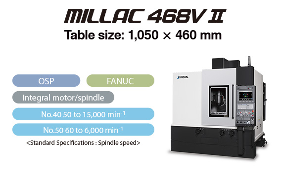

| Item | Unit | MILLAC 468V Ⅱ | MILLAC 561V Ⅱ | MILLAC 611V Ⅱ |
| Table size | mm (in) | 1,050 × 460 (41.34 × 18.11) | 1,350 × 560 (53.15 × 22.05) | 1,600 × 610 (62.99 × 24.02) |
| Spindle speed | min-1 | 6,000 | 6,000 | 4,000 |
| Tool storage | tools | 20 | 20 | 20 |
| Motor | kW (hp) | 18.5/11 (15% ED/cont) (25/15) | 15/11 (30 min/cont) (20/15) | 15/11 (30 min/cont) (20/15) |
| Machine size (W × D × H) |
mm (in) | 2,265 × 2,995 × 2,790 (89.17 × 117.91 × 109.84) |
2,650 × 3,395 × 2,755 (104.33 × 133.66 × 108.46) |
3,410 × 3,810 × 2,910 (134.25 × 150.00 × 114.57) |
| CNC | OSP / FANUC | OSP / FANUC | OSP / FANUC |

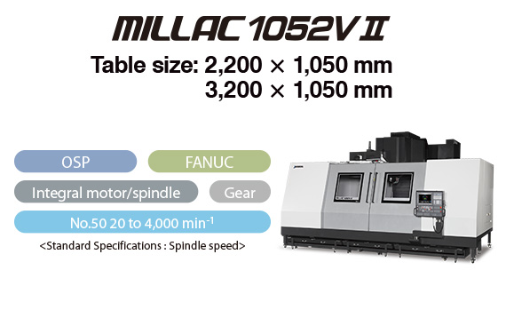

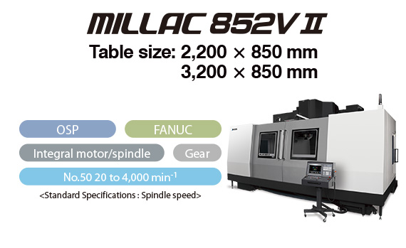

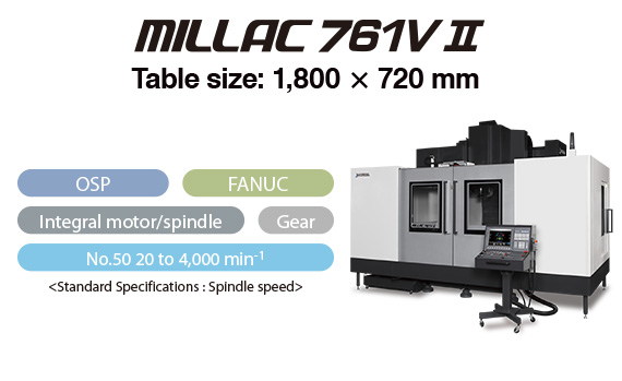

| Item | Unit | MILLAC 761V Ⅱ | MILLAC 852V Ⅱ | MILLAC 1052V Ⅱ |
| Table size | mm (in) | 1,800 × 720 (70.87 × 28.35) | 2,200 × 850 (86.61 × 33.46) | 2,200 × 1,050 (86.61 × 41.34) |
| Spindle speed | min-1 | 4,000 | 4,000 | 4,000 |
| Tool storage | tools | 36 | 36 | 36 |
| Motor | kW (hp) | 18.5/15 (30 min/cont) (25/20) | 18.5/15 (30 min/cont) (25/20) | 22/18.5 (30 min/cont) (30/25) |
mm (in) | 4,300 × 4,160 × 3,230 (169.29 × 163.78 × 127.17) |
5,460 × 4,495 × 3,350 (214.96 × 176.97 × 131.89) |
6,760 × 4,560 × 3,520 (266.14 × 179.53 × 138.58) |
