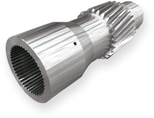

- Reducer component Input shaft(e-Axle)
e-AxleReducer component
Input shaft
Component that transmits power to the reducer
Material: HNCM220M

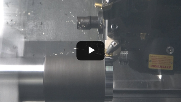

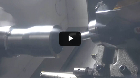

Performing ID and OD gear cutting all on a one turret lathe
- Mass-production parts that include gear machining processes can be completed on a turret lathe
- Hobbing and skiving processes, which normally requires specialized machines, can be done on a turret lathe
- Gears and splines can also be machined
- Process-intensive machining using the Y-axis function
- By using a double tool holder, multiple tools can be attached to a single tool holder to maximize tool utilization on a turret lathe
- Using a double tool holder with the Y-axis function allows high efficient machining
