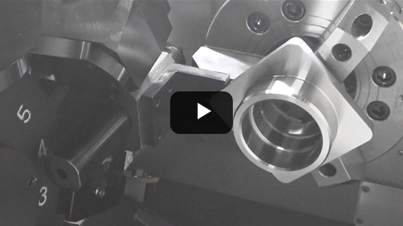

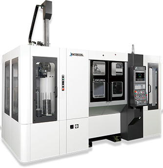

Automation with highly efficient floor space productivity is achieved with a parallel 2-spindle lathe
- Cycle time is shortened with powerful cutting and high-speed loading
- Top-level productivity is achieved with powerful milling
Lathe + Machining processes are integrated into one machine - Non-cutting time is minimized with machine's high-speed capability to load/unload a workpiece in four seconds
Drilling, tapping, high-speed loader (Video is of similar workpiece)

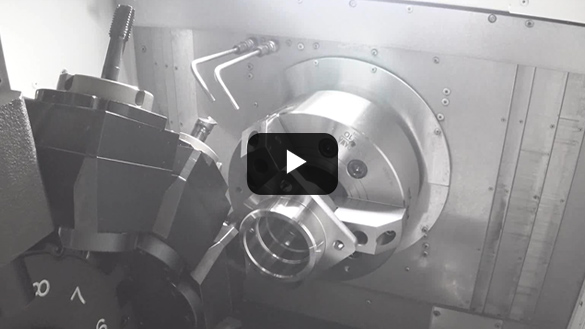

- C-axis phase matching is done easily using C-axis torque skip function
- A stopper is attached to the turret and the machining reference point is brought into contact to read the change in C-axis torque, allowing to achieve C-axis zero offset
- The conventional phase determination device is no longer required, reducing installation space and equipment cost
C-axis torque skip function (Video is of similar workpiece)
