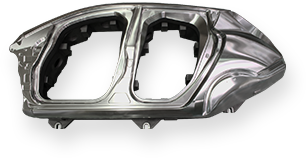

Die for body side panel
Press die for body side panel of cars
Material: FC300

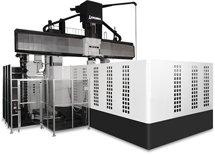

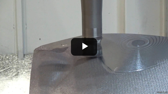

Shortening production lead time for press dies that require high-speed and high surface quality machining
- Rough to finishing machining all completed on one machine
- Cycle time is reduced by 25% using high-speed cutting with a cutting feed rate of 20 m/min
- Hyper-Surface automatically makes corrections to the part program
Finishing machining process is reduced due to high quality machined surface - Thermo-Friendly Concept minimizes dimensional variations between the two halves of the die and reduces time required for die matching

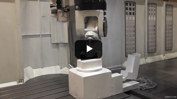

Rough and finishing machining
- Improve efficiency with on-machine measuring
- Swivel-type image sensor is used to measure tool edge position with high accuracy
- On-machine measuring eliminates the need to transport and setup workpieces to a coordinate measuring machine
Swivel-type image sensor and on-machine 3D measuring
