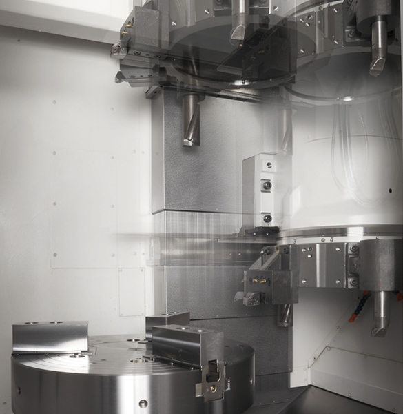

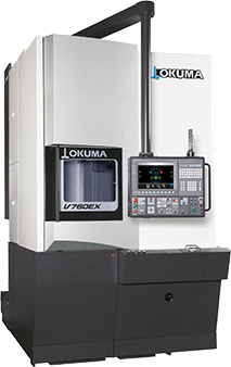

Innovative floor space productivity achieved with a vertical lathe
- The workpiece is secured firmly under its own weight
Ideal for machining large-diameter and thin workpieces -
- Stable chucking can be done even for thin large-diameter workpieces and irregular shaped parts
- Smooth chip discharge is achieved using chip washing and stainless steel chute. Both standard specifications.

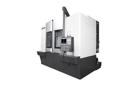

- High productivity achieved with a machine that can handle the workload of two machines, the 2SP-V760EX
- This 2-spindle specification machine consists of the standard R machine (right) combined with an L machine (left) that has a left-right reversal structure. A single control device operates both.
- The R machine and L machine can conduct different processes of production or machine different workpieces, all controlled using a single operation panel
- By integrating the R and L machines, maximum productivity is achieved within minimum floor space
