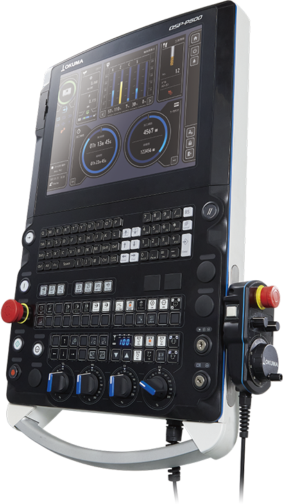

OSP
A next-generation CNC that makes customer manufacturing DX (digital transformation) a reality
Next-generation CNC
Improved productivity and stable production
As Your Single Source for merging M-E-I-K (Mechanics - Electronics - IT - Knowledge) technologies, Okuma offers this CNC to build an advanced “digital twin” that faithfully reproduces machine control and machining operations and creates new value.
In addition, the product helps improve productivity and achieve stable production, featuring ease of use that allows customers to use their machining know-how. Additional features are: control technology that achieves high-speed and high-accuracy machining, energy-saving solutions that achieve both high accuracy/productivity and eco-friendliness, and robust security functions to protect against the increasing threat of cyber attacks.
- Faithful digital reproduction of machines and processing Ground-breaking concept of a digital twin
- Realizing high-speed and high-accuracy machining Leading-edge machining
- Novice-friendly smart operation Innovative operability
- Reducing environmental impact Energy-saving solutions
- Increasing cyber resilience Robust security
