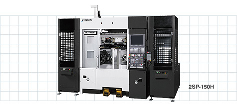

Stable machining accuracies with the Thermo-Friendly Concept Standard loader reduces line tact times Parallel 2-Spindle CNC Lathe 2SP-150H
Machine Specifications
Capacity Chuck size 6 in [8 in]
Max turning dia mm (in.) ø150 <ø220>*1 (ø5.91 <ø8.66>)
Max turning length mm (in.) 80 <150>*1 (3.15 <5.91>)
No. controlled axes 4
Travels X axis mm (in.) 150 (5.91)
Z axis mm (in.) 155 (6.10)
Spindles Speed range min-1 (rpm) 50 to 4,500 [6,000]
No. of speed ranges min-1 Infinitely variable
Nose ø140 (ø5.51) flat
Bore dia mm (in.) ø42 (ø1.65)
Bearing ID mm (in.) ø80 (ø3.15)
Turrets Type V12
No. of tools 12
OD tool shank mm (in.) □25 (1)
ID tool shank mm (in.) ø40 (ø1.57)
Rapids (X-Z) mm/min (ipm) 24,000 (945)
Motors Spindle (30 min/cont) kW (hp) 11/7.5 (15/10) × 2
Saddle (X) kW (hp) BL 2.5 (3.4) × 2
Cross slide (Z) kW (hp) BL 2.5 (3.4) × 2
Machine size Height *2 mm (in.) 2,593 (102.09)
Floor space *3 mm (in.) 1,850 × 2,150 (72.83 × 84.65)
Weight *4 kg (lb) 5,000 (11,000)
[ ] : Optional
*1. < > : Machine capacity without loader application
*2. With max loader height
*3. Machine only
*4. Loader included
