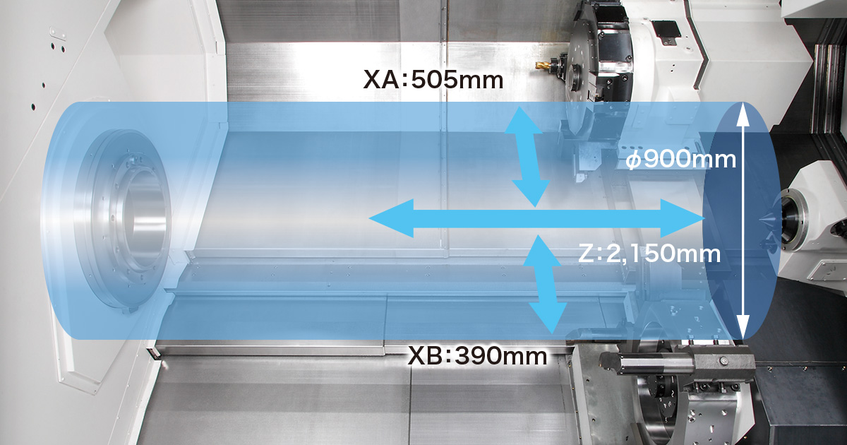

- A 2-saddle lathe that can machine large workpieces with max turning diameter of ø900 mm and max workpiece weight of 11,000 kg (Optional). High rigidity, high power spindles (45 kW, 55 kW, 75 kW) that provide stable heavy-duty cutting with full utilization of the upper and lower turrets are available. Further dimensional stability is achieved with use of the Thermo- Friendly Concept.

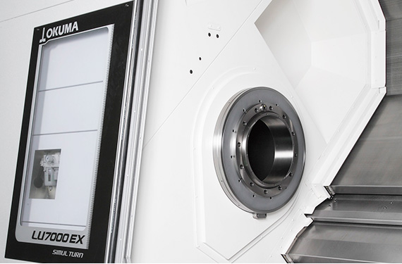

ø375 B15 Spindle

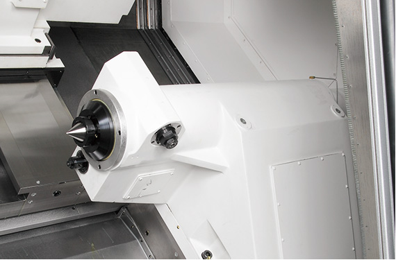

Self-traveling tailstock (Optional)

| Max turning dia | ømm (øin) | U: 900, L: 670 (35.43, 26.38) |
| Max work length | mm (in) | 2,000 (78.74) |
