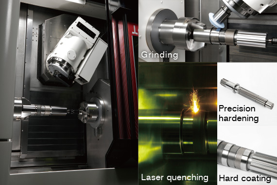

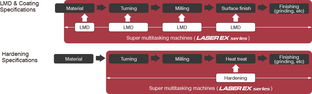

Process-intensive heat treatment

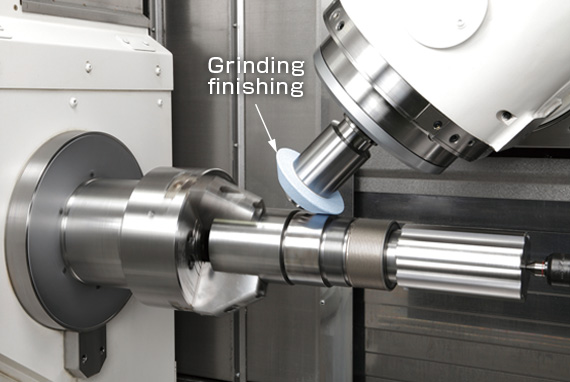

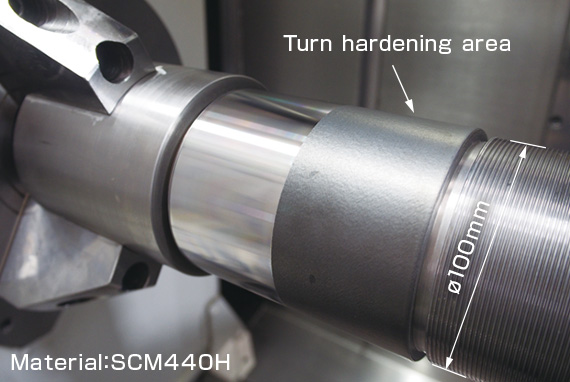

Process-intensive turn hardening and grinding
・Cutting and grinding interrupted by heat treatment can be completed on a single machine with no setup change.
・Uniform-width turn hardening using a high-output, stable laser. Case hardening on cylindrical surfaces with no uneven hardening and little warping is possible.

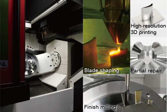

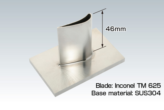

  • Sample① Blade shaping
    Processing heat-resistant alloys (InconelTM) by high-efficiency printing and high-quality simultaneous 5-axis machining
    ・Combines precision additive and cutting operations
    ・Makes possible deposition of metals of different types

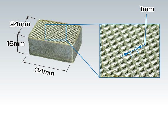

  • Sample② Mesh fabrication by precision additive manufacturing
    ・Makes possible uniform-width forming using a stable laser
    ・Achieves high-resolution, thin additive manufacturing of 1 mm or less

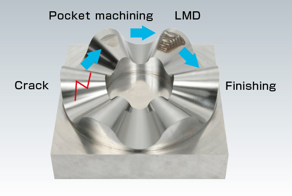

  • Sample③ Resin mold repairs
    ・All operations from crack removal to finishing on a single machine
    ・Even accommodates hard-to-cut and high-hardness materials

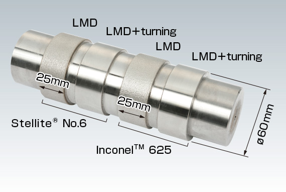

  • Sample④ Coating
    ・Process-intensive machining with uniform coating and finishing
    ・No need for sandblasting or other preprocessing
    ・Switchable among multiple coating materials
