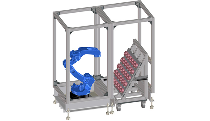

Packaged sets of system building equipment are available. Signal confirmations of the robot have already been done at the time of shipment. When installing, just setting up the integrated robot/workpiece stacker CAC and connecting the power supply and network cable will complete the setup. Setting up an automated system easily, without a system integrator, is possible.

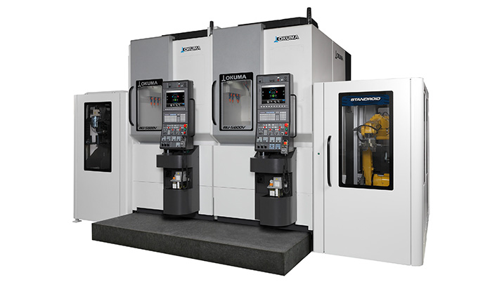

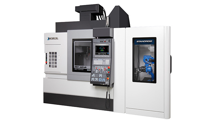

5-axis machining center + STANDROID -
VMC + STANDROID

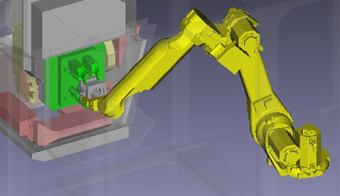

3D simulation to check collisions in advance
(MU-S600V + STANDROID)
③ Collision-Free Control assures safe and smooth operations in a compact automated cell
Simply inputting the start and end points of motion by interacting with the CNC operation panel, Collision-Free Control automatically creates the shortest non-interfering routes in a tight space for easy operating confirmation.

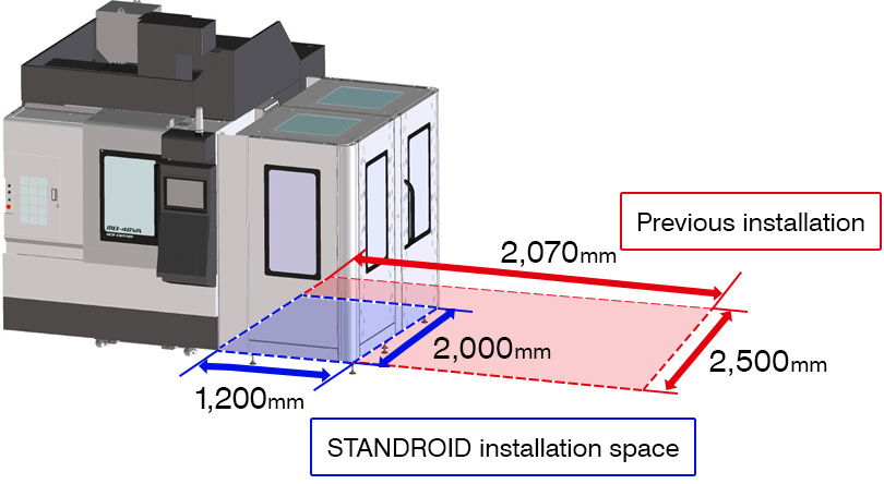

The robot, workpiece stacker, and other related equipment are minimally packaged in a space of only about 2 pallets.
Conventionally, the need for space for the movable range of the robot that was surrounded by a safety fence, is no longer needed.

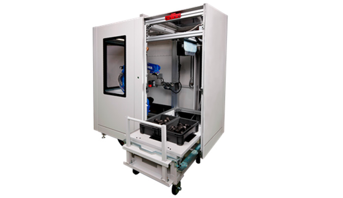

Mobile compact workpiece stacker -
Workpiece stacker for long-run continuous operations
