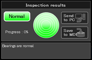

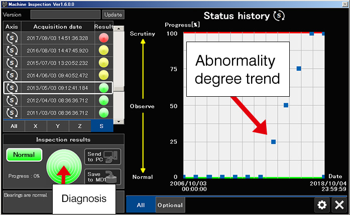

② Visualizing the bearing status, with icons
Depending on the state of the spindle bearings, the color of the icon and the degree of numerical abnormality are displayed on the screen. In addition, by using abnormality trend indicators, it is possible to plan maintenance by predicting abnormality progressions.
Diagnosis trends and abnormality degree -
Diagnosis (enlargement)

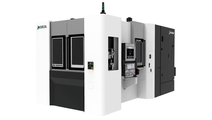

MB-5000HⅡ -

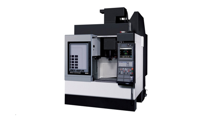

MB-46V
