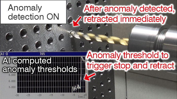

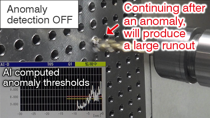

① Detection of sudden drilling abnormalities
Drilling abnormalities can be detected early to stop the operation before a tool breaks and retract it to minimize tool or workpiece damage.

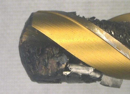

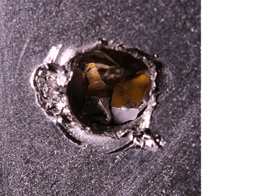

Damaged cutting edge,
Chip clogging -
Damaged hole

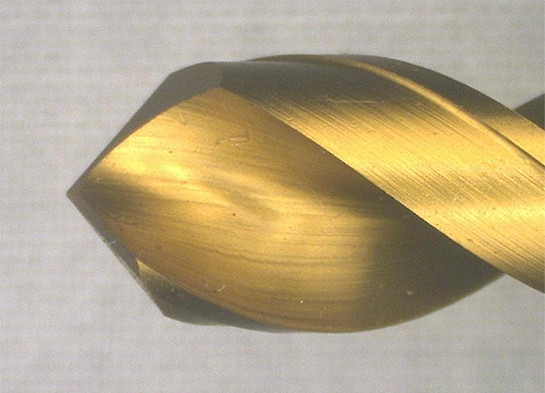

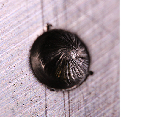

Cutting edge without damage -
Hole without damage

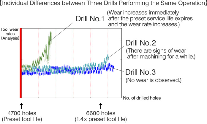

② Visualization of wear conditions (world’s first)
Drill tool wear conditions can be accurately plotted in graphs. Drill replacements can be optimized to provide drastically reduced tooling cost benefits.
