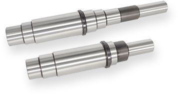

- Reducer component Motor shaft (e-Axle)
e-AxleReducer component
Motor shaft
Component inserted into motor rotor
Material: S45C

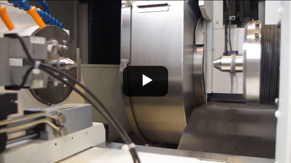

Shortening non-operation time with automatic setup change

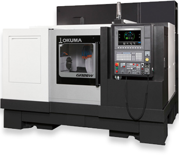

- The NC tooling stand + wide range sizer and NC tailstock makes it easy for anyone to operate, increasing operating rate
- The Z-direction position and measuring diameter of the sizer can be flexibly changed by NC commands
The dimensions of the outer diameters of all workpieces can be monitored and controlled - The support position and thrust on the tailstock side can be flexibly changed using only NC commands
Workpieces with different lengths and weights can be handled

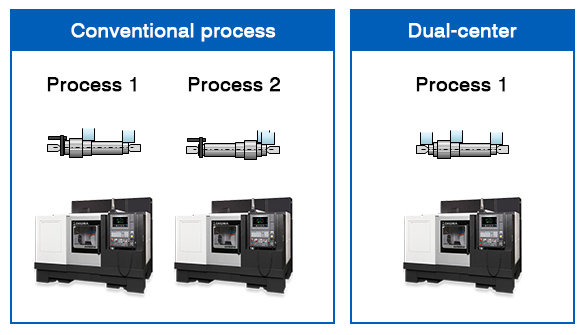

- Workpiece load/unload is easier with the dual-center drive specification
- The whole area of the outer diameter can be machined without chuck change with the dual-center drive specification
The workload on workers is reduced with no need to turn over workpieces - Two processes are integrated and handled on one machine, allowing operator to reduce the number of machines required in the factory and reducing power consumption
