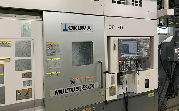

- Issues
Dimension compensation required many times a day
- With 4 VMCs and 2 CNC lathes on a dedicated production line, setup changes are time consuming.
- Warm-ups are required, and thermal deformation along the Z/Y axes vary.
- Implementation
Changed to continuous processing with 2 multitasking machines.
Using Thermo-Friendly Concept to achieve stable accuracies even with continuous long runs.
- Effectiveness
Stable dimensions even during long continuous runs
- There was no need to make dimensional corrections, and after full operation for 24 hours, there were no problems with post-process operations.
