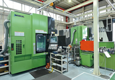

Parts machined per day increased from 35 to 60.
Operator move time required between the drilling machine and the lathe, and part load/unload time was reduced, and actual cycle times greatly improved. The target is machining 70 parts per day.
Cycle times reduced 1/2 ~ 1/3
The 15-to-20-minute cycle times done on the previous line have been reduced to 5 to 10 minutes with the MU-V.
Responding to ever-increasing additional machining requirements by significantly reducing cycle times
Before installing the MU-V, we used three machines for prepared hole drilling, turning on a lathe, and boring to provide our shaft/hole additional machining service, completed within one day after receiving the order. Now, all that is possible on one MU-V, and cycle times which used to take 15 to 20 minutes per workpiece, has been halved from 10 to 5 minutes by the MU-V. In addition, the previous production line had a machining limit of 35 pieces per day, but now that has been increased to around 60 pieces a day.
Truly operator friendly
This was our first 5-axis machine, and only the younger NC lathe operators had previously used Okuma machines. We were worried about effectively using the new equipment, but after the introductory course, operations went smoothly. Access to both machines is very good, and setup jobs are burden-free for the operators who load/unload parts dozens of times a day.
In addition, since Okuma's 3D Virtual Monitor can pre-check for interference on a personal computer, the prep time before actual machining has become much shorter. Okuma's Collision Avoidance System (CAS) can also provide interference checks on the operation panel for worry-free operations to help improve initial part setup productivity, which was previously done with slower feed rates. It also helps to be able to check machining accuracy measurements, maintenance information, and instruction manuals on the large operation screen at the machine.
