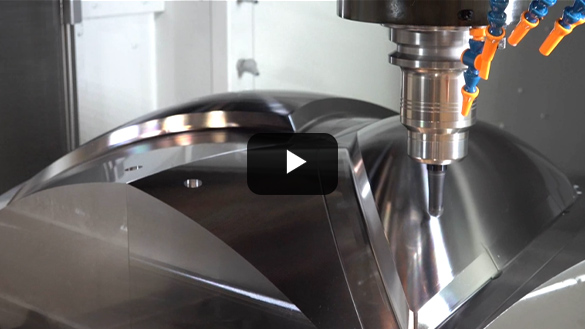

Resin mold for headlights
Material: FC300
Completing machining of large die/mold with one machine
Significantly reducing production lead time
- Rough to finishing machining are completed on one machine
- Cutting time is shortened by using a high power spindle to achieve high-efficiency roughing
- High-quality finishing of molds
Hyper-Surface automatically compensates disturbances within the part program
Hand-finishing time is reduced by improving the surface quality of molds
Finishing machining

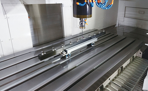

- High measurement and machining accuracy is maintained
- Accuracy Stability Diagnosis Function allows the machine to self-diagnose changes in machining accuracy, and is visualized for the machine operator
The effects that change in room temperature has on machining accuracy is visualized, ensuring the reliability the machine's measurement and machining abilities - 3D Smart Calibration System to calibrate the volumetric accuracy of the machine
High measurement and machining accuracy are ensured through periodic inspection and calibration of machine accuracy - The machine autonomously maintains high accuracy in a stable manner with the Thermo-Friendly Concept
Compensations are made with consideration of the expansion and contraction of workpieces, in addition to the thermal deformation of the machine
This enables conducting highly accurate measurement and machining within a typical factory environment
