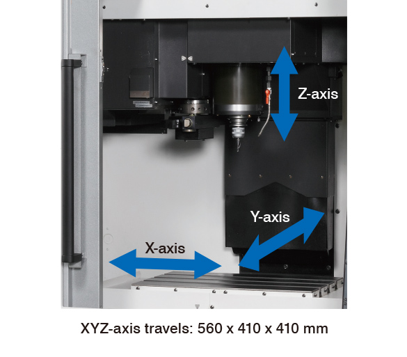

Highly productive and efficient, high quality cutting
- X, Y, Z axis slideways
- The slideway on each axis is a highly rigid box way, enabling high vibration absorbance, high quality machining.

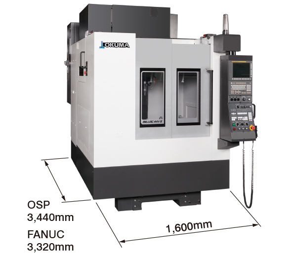

| Machine size (W × D × H) |
mm (in) | 1,600 × 3,440 × 2,400 (62.99 × 135.43 × 94.49) |
1,600 × 3,550 × 2,600 (62.99 × 139.76 × 102.36) |
