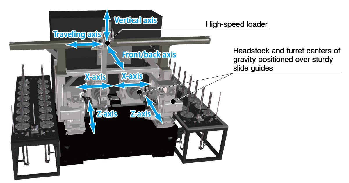

- Machine structure for high-speed loading and powerful machining
- Workpiece load/unload time has been reduced to 4 seconds, and machining-to-part transport line takt time has been minimized. Moving component (headstock, turret) centers of gravity have also been positioned over sturdy slide guides.

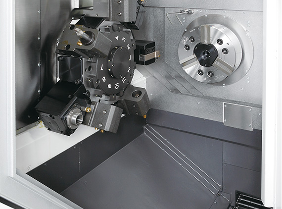

Powerful, accurate machining has been achieved with the best machine structure possible for mass production.
- Productivity improved with significantly stronger spindle
- The spindles are faster and more accurate with integral motor/spindle drives. The milling tool spindles also have higher output of 7.1 kW, increasing torque to 1.25 times that of the previous machine and doubling end millling capacity to 65 cm3/min. Process-intensive mill/turn operations have become possible.

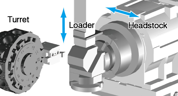

- The shortest line takt times with a high-speed loader
- During workpiece load/unload, the headstock moves to that position. The loader can enter the machine regardless of turret position.
In addition, with servo-driven hand rotation and faster speeds of all movements, workpiece load/unload time of 4 seconds* has been achieved.
* Does not include upper door open/close time.
The load/unload time of 4 seconds is actual data; different operating conditions may require more time. -

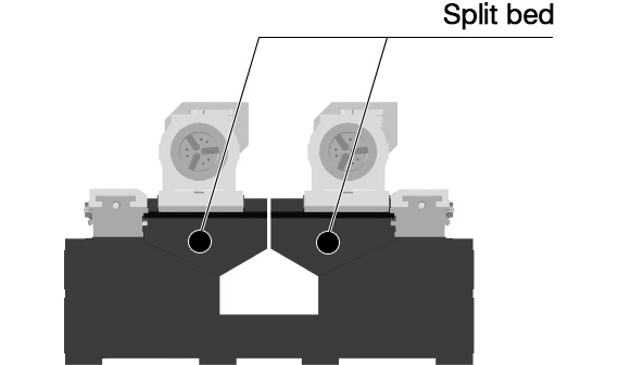

- Split bed for high-quality machining
- A split construction is used for the bed. Transmission of vibration during cutting is inhibited by separating the right and left sides.
This is also effective when high surface roughness is required.
