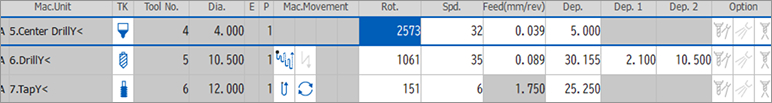

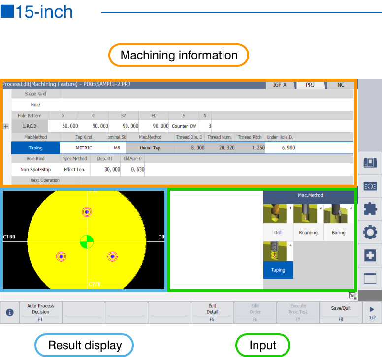

Smart OSP Operation

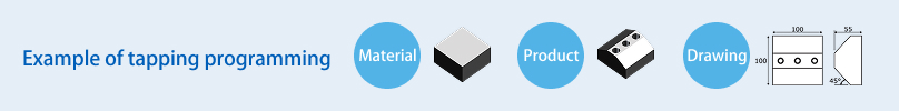

Creation of machining programs without G-/M-code
Simply following the guide and entering drawing information automatically creates a machining process.
For example, in the case of tapping, three machining processes - center hole, drilling, and tapping - are generated all at once.
Example of tapping programming

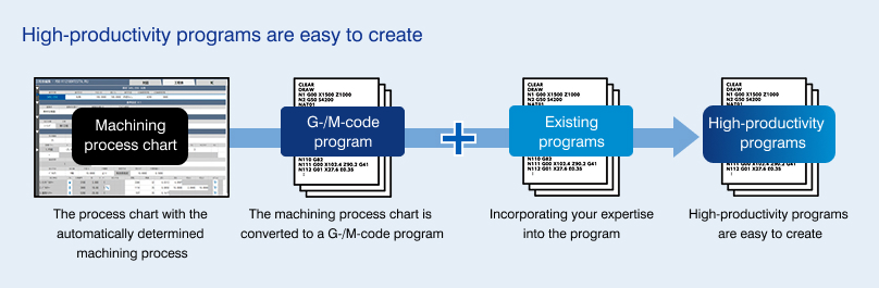

A program created using interactive functions can be easily converted to G-/M-code to reflect know-how.
High-productivity programs are easy to create.
Smart OSP Operation
Customer's know-how is reflected in programs.
The generated machining process chart can be converted into G-/M-code.
You can insert and use highly productive programs that incorporate your know-how.

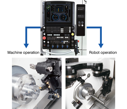

The panel position is adjustable, reducing strain on the body.
User-friendly operation panel with improved visibility and operability
We have prepared two lineup types that take into consideration operability and the space required for installing the machine.
It is equipped with a tilting mechanism, which allows you to change the tilting of the machine operation panel on the 21.5-inch model, and the tilt of the entire panel on the 15-inch model.

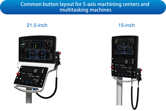

PC-style keyboard layout common to both 5-axis machining centers and multitasking machines has been adopted. Even an operator performing single-operator multitasking can operate smoothly.
Operable with wet hands or gloves thanks to the pressure-sensitive touch panel.
Common button layout for 5-axis machining centers and multitasking machines

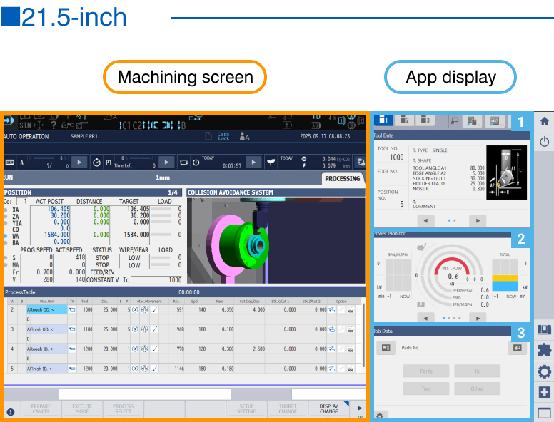

View solution
The desired information can be checked at a glance, and intuitive operation is possible.
All the information you want to see is neatly displayed on one screen.
Reduces screen transitions and allows you to obtain the necessary information for machining with minimal operations.
The machining program creation screen for Smart OSP Operation allows you to check input, machining information, and results at a glance. Since you can immediately check the results of your input, you can quickly create a program.
With the 21.5-inch model, you can simultaneously display three of your favorite apps during operation.
You can select and display the app you need depending on the machining, so you can proceed with machining without stress.
15-inch
21.5-inch

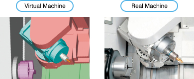

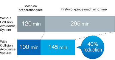

Since there is no fear of collisions, you can focus on machining preparation with peace of mind.
Eliminates machine collisions for safe operation
Collision Avoidance SystemCollision Avoidance System
Prevents machine collisions in both automatic and manual operation
Especially useful for machine operators setting up a job, collision avoidance in manual mode provides collision-free confidence and faster machining preparations.
Realistic simulation of workpiece cutting
Machine preparation First-workpiece machining
Workpiece shape during machining is displayed accurately and interference checks are performed.

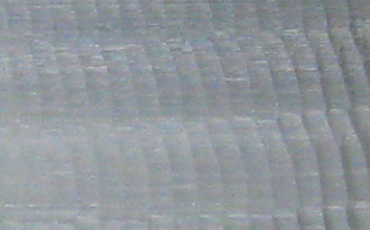

Highly efficient machining conditions without chattering can be determined quickly.
Leaving it to the machine suppresses chattering and increases productivity.
Machining NaviMachining Navi
Maximizes the capabilities of machines and tools
Cost reduction, which is unavoidable to win in tough competition
To solve this issue, "shortening machining time" and "improving productivity" are required.
"Machining Navi" is a revolutionary tool that allows anyone to easily maximize the capabilities of machines and tools by "visualizing" the machining status.
Suppresses chattering in milling and further improves machining
  • Normal machining
Spindle speed:11,000[min-1]
Feed rate:2,200[mm/min]
Normal machining
  • Machining Navi
  • 45%UP
Spindle speed:16,225[min-1]
Feed rate:3,200[mm/min](actual data)
Machining Navi

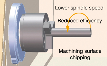

Suppressing chattering without using a follower rest improves productivity.

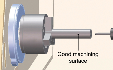

Suppresses chattering during turning and further improves machining
Workpiece material:Alloy steel
Workpiece: ø50×220mm
Tool:L/D=6.6(ø12×80mm)

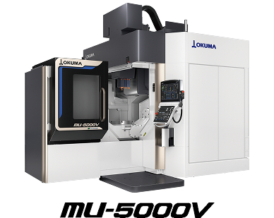

Thermal deformation over time 7μm
(actual data) (room temperature change of 8°C)
MU-5000V
Thermal deformation over time 10μmor less

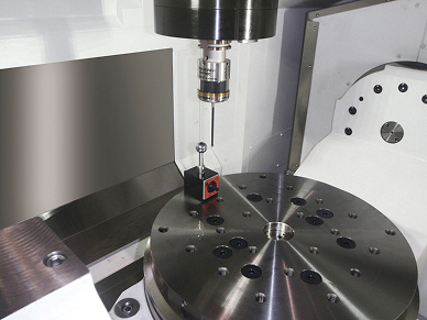

Achieving stable measurements without relying on the skills of the operator
On-machine 3-D measurement of workpieces on a 5-axis machining center and multitasking machine
NC Gage

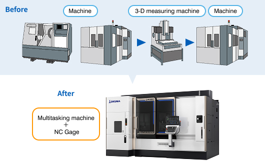

Process integration of 3-D measurement. Setup change unnecessary, significantly reducing lead time.
When measuring large 5-axis or multitasking workpieces with a 3-D measuring machine, setup changes are required because the workpiece must be repositioned multiple times on the measuring machine using a crane according to the measurement points.
Furthermore, if the measurement result is not acceptable, the workpiece will have to be reattached to the machine for remachining.
Performing 3-D measurement on the machine enables speedy work without the need to load and unload workpieces or change setups for each measurement point. Once a measurement program is created, the same workpieces can be measured automatically.
NC Gage
  • Intuitive operability and a wide variety of measurement options.
  • Measurement programs are automatically generated through teaching.
  • Measurement of geometric errors is also possible.

Speedy measurement is possible without transferring the workpiece or changing the setup for each measurement point.
NC Gage Process integration of 3-D measurement. Setup change unnecessary, significantly reducing lead time.
NC Gage
Multitasking machine + NC Gage

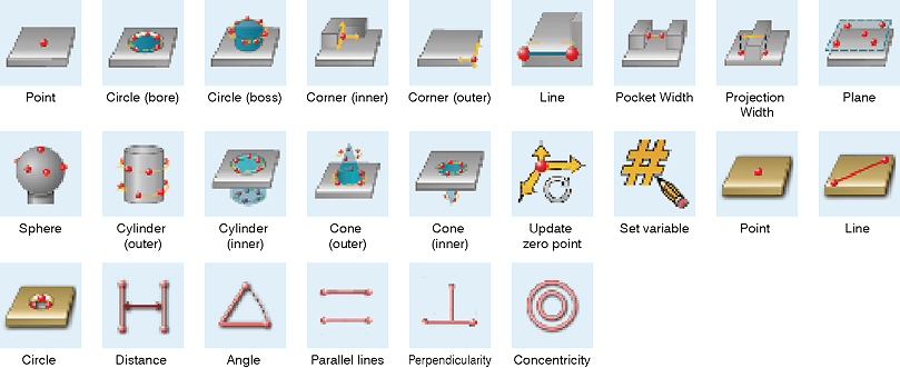

A variety of measurement programs can be created through intuitive teaching without using complex macros.
Measures any dimension for quality management
NC Gage Utilizes 3-D measurement data for quality management
You can easily create programs on-site for more than 20 types of measurements, construction, and calculation functions, as well as work offset updates.
"A measurement program is automatically generated through intuitive teaching by the machine operator."
The measurement results can be used for quality management and reports can also be saved.

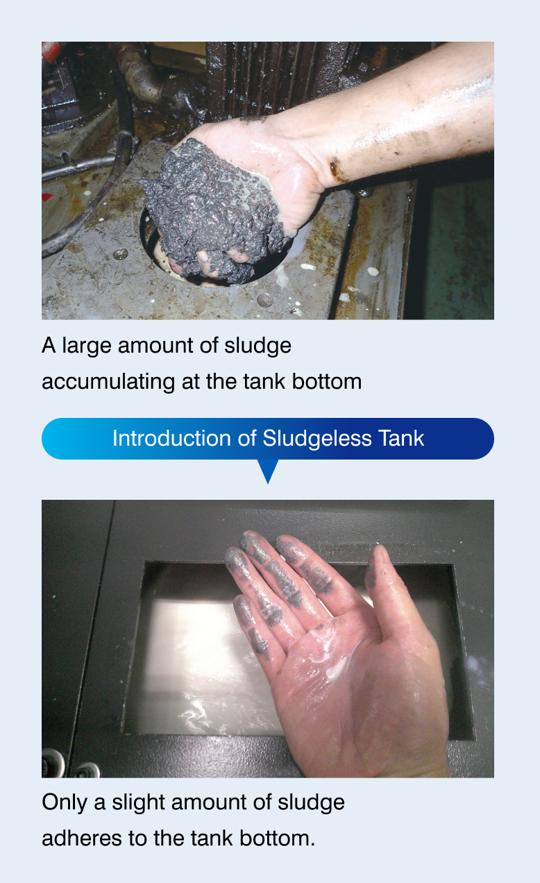

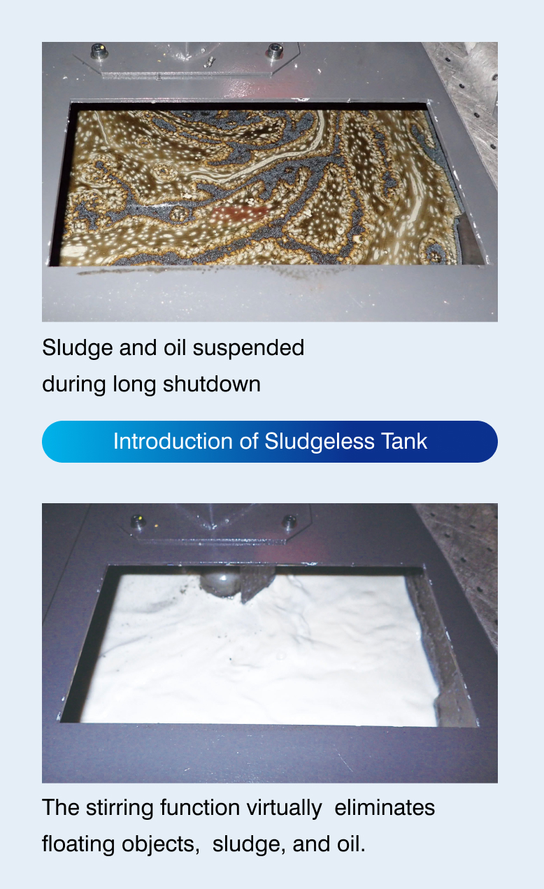

Tank cleaning can been drastically reduced to once every three years.
Fewer machine breakdowns caused by sludge has led to stable operation.
Significant reduction in maintenance work
Sludgeless Tank
Suppresses deterioration of coolant (cutting fluid) and reduces waste fluid volume.
By constantly circulating the coolant inside the tank at a constant speed and efficiently collecting sludge, sludge accumulation is prevented, and problems and maintenance work are significantly reduced.
Sludge removal rate99%
(when the material is casting and aluminum)
Notes: After secondary filtration (cyclone filter) permeation
Okuma evaluated removal rate
No tank cleaning for 3 years
(Okuma equipment actual data)
No replacement for 3 years
Introduction of Sludgeless Tank
View solution

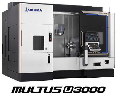

No robot programming is required, thus even beginners can use it.
Significantly improves operating rates of multiple machines: even on a shop floor with multiple machines and only a single operator

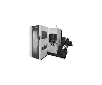

ARMROID, which integrates a robot into the machining chamber of a multitasking machine, allows anyone to operate it easily without creating robot programs, enabling simple switching between small-lot manual machining and mass-production machining with a robot.
MULTUS B250Ⅱ ARMROID
Easy machine tool or robot operation by any operator
Okuma's intelligent machine tool CNC enables real time gesture control of both the robot and machine tool.
