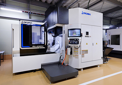

Sekidai Kogyo Co., Ltd.
Process integration of difficult-to-machine materials and complex shapes through high-precision 5-axis machining. Lead times for large workpieces reduced by 50% and strengthening ability to meet short delivery dates
Please share why you decided to install a 5-Axis Vertical Machining Center
Our company specializes in doing high-mix, low-volume precision machining for a wide range of industries, primarily for motorcycle and automotive, as well as semiconductor manufacturing equipment and medical devices. One of our key strengths is our ability to do precision machining of difficult-to-cut materials such as Inconel and titanium.
Up to now, we have strived to do process-intensive machining using 5-axis machining centers and multitasking machines. However, we started to receive orders for large workpieces that were difficult to handle with our existing equipment. There was an urgent need to add a large 5-axis machining center to establish a stable production system that could do precision machining within short delivery deadlines.
What made you choose Okuma?
The large automotive suspension components we needed to produce required to be machined from multiple directions and demanded precision accuracy with tolerances of 10-20 μm. To meet the required accuracy while achieving short delivery times, a 5-axis machining center that could machine efficiently while maintaining stable high-accuracy for long periods was essential.
To achieve short lead times under strict quality control, we selected the MU-6300V as a candidate for a new machine, as it enables highly efficient machining while maintaining high precision over extended periods of operations.
Previously, machining was divided into four processes using existing vertical machining centers. However, with the addition of the MU-6300V, it is now possible to consolidate the machining stages into two processes. In addition to making lead times shorter, we believe it offers significant cost-effectiveness by reducing operator workload and lowering fixture costs.

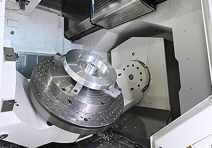

Maximizing the benefits of 5-axis machining by utilizing intelligent technology
After installing the MU-6300V, how would you evaluate its productivity and ease of use?
Previously, repeated clamping and unclamping across multiple processes caused distortion of the workpiece and dimensional errors. However, by consolidating four processes into two, measurement and corrective machining at each stage were eliminated, resulting in a 50% reduction in lead time. Moreover, the number of fixtures required had been reduced by half through process integration, allowing fixture manufacturing costs to be reduced in half as well. As productivity has improved, we've gained additional capacity, enabling us to machine other parts, which in turn has contributed to improving the overall utilization rate of the factory.
With the MU-6300V, we also perform precision machining of difficult-to-cut materials such as titanium, Inconel, and stainless steel. These materials require a long time to machine and impose heavy loads on the tools. Maintaining accuracy and managing tool life are general issues. The MU-6300V achieves exceptional dimensional stability through the synergistic effects of its high machine rigidity—which suppresses spindle vibration during machining—and Okuma's intelligent technology, the Thermo-Friendly Concept. This enables stable, high-precision machining even during long continuous operations exceeding 20 hours.
To machine cylindrical workpieces of intake systems, simultaneous 5-axis machining is performed by cutting from both sides and connecting at the center. However, to maintain machining accuracy, it is also important to compensate for various geometric errors.
For automatic adjustment of geometric errors such as rotary axis misalignment, we use 5-Axis Auto Tuning System Ⅱ.
Generally, 5-axis machining centers are difficult to operate because they include both linear axes and rotary axes. Because of this, they are often handled by experienced operators. 5-axis machining centers are generally perceived as difficult to operate. However, the MU-6300V is user-friendly even for beginners. Supported by the confidence provided by Collision Avoidance System, which prevents in-machine collisions, many young employees have taken on the challenge. As a result, five-axis machining is now becoming the standard at our company.

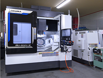

ALI Co., Ltd
Reducing machining lead time for medium-size workpieces for semiconductor manufacturing equipment by 50% and reducing operator workload during setup changes
Aluminum parts for semiconductor manufacturing equipment require extremely strict machining accuracy, with geometric tolerances of 0.01 mm or less and surface roughness values of RA 0.2-0.4 μm or lower. For workpieces up to ø400 mm, we used an MU-400VⅢ 5-axis vertical machining center which we first installed in 2021. But demand for workpieces in the ø500-600 mm range had been increasing in recent years and this size could not be done on the MU-400VⅢ. We had no choice but to split the manufacturing process between a horizontal machining center due to interference issues, tool length limitations, and other constraints. Significant amount of time and labor were required for setup changes and accuracy checks. Under the demand for short delivery times, achieving both lead time reduction and decreasing operators' workload had become an ongoing issue.
ALI Co., Ltd
The MU-400VⅢ we already owned always met the required accuracy for workpieces. We also valued its compact design which shortens tool travel distance within the machine and its high-speed ATC which enables highly efficient production.
On the other hand, workpieces over ø400 mm required reprogramming and tool adjustments to avoid interference, so we considered the MU-500VⅢ, which has a table one size larger. We believed this machine size could handle ø500-600 mm workpieces smoothly, allowing machining of workpieces to be done without stress.
Based on our experience with the MU-400VⅢ, we concluded that the MU-500VⅢ was the best choice, as it meets three key requirements: stable high-precision machining, a compact footprint almost equal to our existing MB-56VⅡ vertical machining center, and better production efficiency.
ALI Co., Ltd
ALI Co., Ltd
ALI Co., Ltd

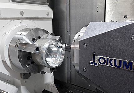

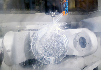

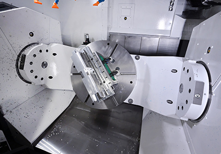

Increasing factory's machine utilization rate through process-intensive machining, contributing to expansion of sales
After installing the MU-500VⅢ, how would you evaluate its productivity and ease of use?
When machining semiconductor manufacturing equipment parts, what we value most is the ability to consistently achieve the same level of precision every time for every part. Therefore, before installing the MU-500VⅢ, we carefully evaluated its rigidity and machining capacity by comparing it with our existing 3-axis vertical machining center, the MB-56VⅡ. When we actually used the MU-500VⅢ, we found that both its machining accuracy and machining capacity matched those of the MB-56VⅡ, giving us the confidence to proceed with process integration.
Among its features, the one we found most valuable is Hyper-Surface Ⅱ. This function compensates for irregularities in CAM-generated data at the NC level, enabling us to achieve streak-free surface quality while maintaining shape accuracy. In particular, core parts of semiconductor manufacturing equipment require strict tolerances of 0.01-0.02 mm or less for flatness, parallelism, and profile. Hyper-Surface Ⅱ is essential for maintaining high-accuracy machining.
Also, when introducing a 5-axis machining center, it is generally necessary to set up cutting conditions from scratch. However, with the MU-500VⅢ, the cutting conditions of a 3-axis vertical machining center used when process was segmented can be utilized. This sped up the startup of parts machining, which directly contributed to productivity improvement.
Previously, when machining process was split between machines, we spent eight hours on workpiece transfer, jig setup/removal, re-chucking, machining, and accuracy inspection. However, after installing the MU-500VⅢ, we were able to complete five-sided machining—from roughing to finishing—in a single setup, eliminating accuracy variations caused by setup changes.
This halved the lead time of the entire process from eight hours to four hours, enhancing our ability to meet short delivery times. We are using the additional capacity created from reduced lead time to increase new orders, improving overal machine utilization across the factory and increasing sales.
ALI Co., Ltd
Thank you very much.

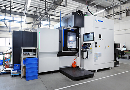

By integrating multiple machining processes into a single machine, time used for setup change was reduced by 35 percent
Consistent dimensional stability and high machining performance—even in 5-axis machining
Now that you have installed the MU-5000V, how would you rate its productivity and ease of use?
With 3-axis machines, each step is split across several setups, so every setup change consumes time and effort. A 5-axis machine can integrate those steps into one machine, allowing us to complete multiple processes within a one-chucking setup which dramatically lightens the workload.
In particular the MU-5000V can handle workpieces requiring angled holes or back-side chamfers in a single-chucking operation, greatly improving overall efficiency.
Because 5-axis machines have more complex kinematics, we expected the effects of thermal deformation to make tight-tolerance work difficult. However, thanks to Okuma's Thermo-Friendly Concept, the MU-5000V delivers the same dimensional stability as our 3-axis Okuma models and requires virtually no thermal-related compensation work.
We have also experienced its outstanding machining capability—it is a machine that cuts exceptionally well.
Components for semiconductors require to have exceptional surface quality. Hyper-Surface Ⅱ automatically corrects tool marks and edge unevenness caused by CAM data, resulting in improved machined surface quality.
Having the idea of doing long hours of unmanned operations overnight in the future, we equipped the machine with a 2-pallet APC configuration which allows workpiece setup to be done even while the machine is running. This is to enable us to increase machine utilization and meet the to meet the growing demand for semiconductor related parts.

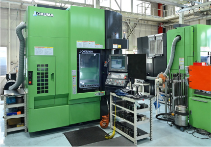

Nabeya Bi-tech Kaisha
The effort required for additional machining of pulley shaft holes has been dramatically reduced, boosting productivity
Please share why you decided to install a 5-axis machining center.
We manufacture power transmission pulleys (castings) used in blowers and commercial air conditioners. We also provide a “shaft hole additional machining service”, which is an additional service to machine shaft holes, screw holes, and keyways to the workpiece. Within a day, machining process is done and product is shipped out. For 30 years, we relied on three machine tools, including a lathe and an in-house-built special-purpose machine, to perform pilot hole drilling, turning, and screw tapping. However, the numerous processes and the need for skilled labor for tasks like diagonal hole machining made it challenging to reduce time. We concluded that investing in a 5-axis machining center was essential to boost productivity.
Given these circumstances, what made you choose Okuma?
While comparing the performance and features of 5-axis machines on the websites of various machine tool manufacturers, my boss encouraged me to visit Okuma and see the machines in person. Therefore, we visited Okuma to thoroughly examine the machining precision, range, and cycle time, as well as operability and ease of use.
In addition to its high basic performance, what stood out to us was the excellent accessibility to the machine, which eliminates the need for climbing stairs. We were particularly concerned about other manufacturers' machines, which required workers to go up and down stairs during setup, creating additional strain for them. Another feature that caught our attention was the collision avoidance system. We were convinced that this feature would significantly reduce preparation time by eliminating the need for operators to perform interference checks on the actual machine. Additionally, we found it highly appealing that measurement results of machining accuracy, maintenance information, and operation manuals could be easily checked on the large operation screen.
Furthermore, since we plan to utilize the machining center not only for additional shaft hole machining but also for custom product manufacturing in the future, we determined that Okuma's 5-axis vertical machining center "MU-V" was the optimal choice. This decision was based on a comprehensive evaluation of machining quality, workability, cost, applicability, and other factors.

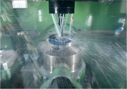

Machining that previously required three machines is now completed by a single machine.
Machining time has been reduced to around 1/2 to 1/3, and machining productivity has approximately doubled.
Now that you have installed the MU-4000V-L and MU-5000V-L, how would you rate their productivity and ease of use?
The preparatory hole drilling, lathe machining, and drilling machine operations, which previously required three separate machines, can now be completed by a single MU-V machine. This has halved the machining time per piece from 15–20 minutes to 5–10 minutes. As a result, the daily production limit, which was previously capped at 35 pieces, has increased to approximately 60 pieces.
The improved accessibility of the machine has also reduced the operator's strain, making setup work much easier and more efficient.
In addition, the “3D Virtual Monitor” enables us to check for interference on a PC in advance, significantly reducing preparation time before actual machining. The operation screen of the “Collision Avoidance System” also allows us to check for interferences in advance, eliminating the risk of collisions. This has made first-part machining, which previously required a slower feed rate, much more efficient. Maintenance information is also accessible through the OSP, with maintenance and inspection schedules clearly visualized. This ensures proper machine maintenance, helping to prevent breakdowns and unexpected shutdowns.

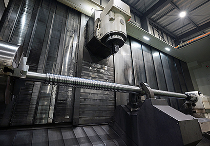

High-mix, low-volume production of high-accuracy large shafts
Expanding business into the seismic isolation device market with the MULTUS multitasking machine
Please share why you decided to install Multitasking Machines
We manufacture ball screw shafts, which enable high-accuracy feeding and positioning in precision machinery, industrial robots, LCD production equipment, and semiconductor manufacturing equipment. We also produce complex nut components with built-in balls. Since ball screws are critical components that determine the basic performance of the final product, strict dimensional tolerances are required, and high-mix, low-volume production with short delivery times is not uncommon.
Previously, the machining process was divided into separate turning and milling operations, which required significant time and effort for changeovers and setup, and often resulted in variations in machining accuracy. To address these issues, we sought to introduce a multitasking machine capable of completing all machining in a single chucking operation, thereby consolidating processes and strengthening QCD—quality, cost, and delivery.
Shirakawa Co., Ltd
It is extremely important that the phase alignment between thread turning and milling operations are precise during the production process. With this in mind, a multitasking machine eliminates concerns about phase misalignments because both operations can be performed in a single chucking operation. We therefore considered installing the MULTUS B300II (sub-spindle specification) for machining nut components used in ball screws. Previously, machining was performed in two separate processes—turning and milling. However, with the sub spindle, the handover of workpieces is automated and enables machining to be completed in a single cycle. This has eliminated variations in machining accuracy and has reduced lead time. At the same time, we also considered the MULTUS B750 (with a 4,000 mm distance between centers) for machining large shafts, which are our flagship products. A decisive factor was its capability to machine workpieces up to ø1,050 mm in diameter and 4,000 mm in length, while maintaining long-term stable machining accuracy. Thermal displacement control is typically difficult with large machines, so being able to maintain stable accuracy was very important. Combined with the machine's high rigidity that enables to cut high-hardness material with ease, we chose the MULTUS B750.
Shirakawa Co., Ltd
Shirakawa Co., Ltd
Shirakawa Co., Ltd
Achieving a 100% on-time delivery rate and a defect rate of just 0.2%
'How does the MULTUS contribute to QCD, and how do you feel about its usability?
The MULTUS made process integration possible, allowing us to shorten lead time and achieve an on-time delivery rate of nearly 100%. In terms of quality, we have maintained a defect rate of 0.2% based on material cost. Supporting this achievement is our company-wide quality control system and well-organized plant environment, as well as the elimination of machining accuracy variation and excellent dimensional stability against thermal displacement made possible by the MULTUS series.
In the past, collisions sometimes occurred even when we believed we had carefully checked movements and interference. This resulted in machine stoppages, repairs, and delivery delays. However, with the standard-equipped Collision Avoidance System, we can run machining simulations in advance, and the axes automatically stop before a collision occurs—even if there is a program input error. This provides exceptional peace of mind and greatly reduces the psychological burden on operators. Even for first-article machining, preparation time has been significantly reduced.

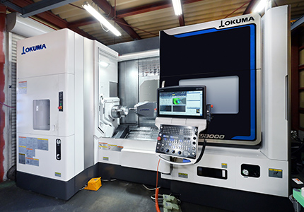

Productivity improved by more than 30% after installing the MULTUS U3000 and insourcing machining processes
Highest monthly sales recorded in the past 40 years
Now that you have installed the MULTUS U3000, how would you rate its productivity and ease of use?
Previously, we conducted turning in-house and outsourced post-processes that were done on a machining center. However, the MULTUS U3000 enables us to conduct all machining in a single-chucking process. As a result of incorporating machining in addition to turning, we are receiving more orders for high-value-added parts with complex geometries. Since we are able to deliver this kind of machining without outsourcing, it has a profound effect when we receive orders for large quantities. For example, when we received an order for 150 units of the same part in a particular month, once we made an NC program for it, all we had to do after that was to set the workpieces onto the machine. The end result was our monthly sales reaching a record high. It reduces the labor and time required for workpiece transportation, minimizes the workload of workers, but also lessens variations in accuracy. This has allowed us to increase productivity by more than 30%.
We receive many inquiries from new customers about new projects in which we are asked if the MULTUS U3000 can handle certain kinds of machining. Compared to before, the types of parts we can machine has increased by 20 to 25. An example of this is a prototype semiconductor-related components that required to cut stainless steel material to a thickness of 3 mm. Although it is not easy to machine such a part, accomplishing this could lead to a mass production order. We are focused on increasing our operation rate even further by fully utilizing the 40 ATC tools on the MULTUS U3000.

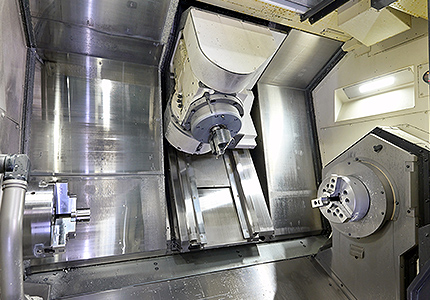

Reducing setup and machining preparation time required when using a lathe and machining center to manufacture components, and eliminate accuracy variations during setup.
Please share why you decided to install a multitasking machine
We manufacture precision parts for industries such as aerospace, medical and optical equipment, and semiconductor manufacturing equipment. Many of these parts have complex geometries and are made from difficult-to-machine materials such as inconel and titanium alloys. All have strict dimensional tolerances and require to be machined within a 10-micron accuracy range. Before installing the MULTUS BⅡ series, we machined these parts using both NC lathes and machining centers. Accuracy becomes difficult to maintain when using several machines to machine a single component, but we made sure we always met each industries’ quality assurance standards.

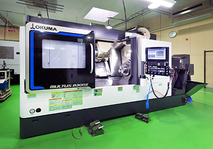

Among the available options, we chose the MULTUS B300Ⅱ (sub-spindle specification) for its high level of fundamental performance and compatibility with workpiece sizes.
The main decisive factor for choosing the machine was its high rigidity. This was an essential requirement for machining difficult-to-cut materials with high accuracy and speed.
Another key factor was the Thermo-Friendly Concept, a thermal displacement control technology that ensures stable machining dimensions. Although we operate using a two-shift operation schedule to keep utilization rates of machinery as high as possible, machine operations stop between 4:00 a.m. to 8:00 a.m. due to an opening between shifts. However, the MULTUS B300Ⅱ is capable of maintaining stable machining accuracy even after a cold start at the beginning of the day shift. This applies even during seasons when outside temperatures are extreme. When machining difficult-to-cut materials, cutting tools are subjected to high loads, resulting in quicker replacement cycles. One superb feature of the machine is that tool life for each indivudual tool can be managed on the OSP system.
Additionally, we had experience of using Okuma’s NC lathes, so we were confident that it would not be diffficult to learn how to program and operate an Okuma multitasking machine.
Tamatec Co., Ltd
Tamatec Co., Ltd
Tamatec Co., Ltd
All machining processes can be completed with a single multitasking machine, resulting in approximately 30% improvement in productivity.
Both high quality and high productivity can be achieved while reducing labor.
Now that you have installed the MULTUS B300Ⅱ (sub-spindle spec), how would you rate its productivity and ease of use?
When processes are divided between a NC lathe and a machining center, significant time and effort are required for tasks such as dimensional inspection, setup changes, and workpiece cleaning. With the MULTUS B300Ⅱ (sub-spindle specification), parts that previously required four processes on two separate machines can now be completed in just two processes on a single machine due to the abiltiy to transfer workpieces between spindles. This has eliminated the need to handle work-in-progress workpieces between machines and has improved the overall production flow.
In addition, because there is minimal phase error during transfer, positioning jigs are no longer necessary. Also, issues that occurred during setup changes—such as scratches, dents, and the need to remachine due to size errors—have been drastically reduced. As a result, we have been able to significantly reduce tasks that were required between processes, resulting in a productivity improvement of approximately 30%. All this is done while maintaining micron-level machining quality. Even when machining complex parts that require various cutting and drilling operations, the MULTUS can be left unattended for approximately 30 to 60 minutes. During that time, operators can focus on preparing for the next process or conduct quality checks, which helps reduce the workload for operators managing multiple machines.
There was a motor shaft job that our competitors had refused because they could not meet its strict accuracy requirements. However, we took the job and were able to succesfully meet the various tolerances that were required for the workpiece.
In addition, the MULTUS B300Ⅱ (sub-spindle specification) features a highly rigid milling spindle, allowing it to machine tough-to-cut materials such as Inconel and titanium alloys with ease. Even at high spindle speeds. The machine also offers exceptional repeatability, enabling stable machining of precision components with tight tolerances—such as medical device parts—with dimensional accuracy in the 10-micron range.
Tamatec Co., Ltd

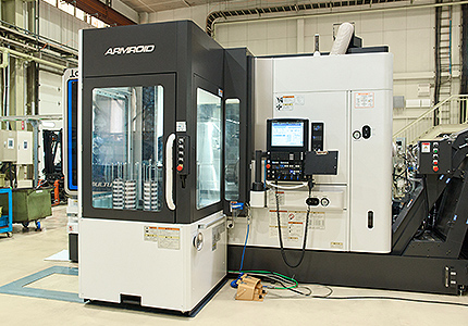

Please share why you decided to install a Multitasking Machine + Built-in Robot.
We are a manufacturer of wire stranding machines (bunchers), which are used to produce cables and wire harnesses for automobiles, aircraft, mobile devices, and medical equipment. Our machines are delivered to numerous customers, including those in over 20 countries worldwide.
All core components of the bunchers are manufactured in-house. One such component is the guide wheel, a pulley used to feed metal wire.
Its V-groove must be machined with high precision in order to smoothly feed ultra-fine metal wires—which are thinner than a human hair—at high speeds.
Until now, machining the guide wheel required five steps: two performed by an automated system consisting of an NC lathe and external robot, followed by drilling and finishing processes.
Setup changes were both labor and time intensive, while the safety fences consumed valuable floor space. Reducing lead time and achieving space efficiency had been ongoing challenges.
At that time, Okuma proposed consolidating several machining processes into one machine using the MULTUS B300Ⅱ ARMROID, a multitasking machine with a built-in robot.
KINREI MACHINERY CO., LTD.
We have used many Okuma machines. We actually already have two multitasking machines which we have been using for some time now: the MULTUS B300 and the MULTUS U4000.
Given the situation, the proposal to consolidate several processes—previously performed with multiple machines and material handling equipment—into a single machine was very appealing, as it offered significant reductions in lead time and space usage.

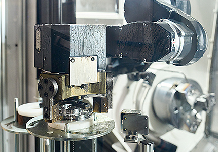

What made the MULTUS B300Ⅱ ARMROID especially attractive was its built-in robot arm. Compared to our previous methods of machining, this machine would allow us to increase productivity while only requiring minimum space to install the machine and mobile workpiece stocker. In addition, the ability to ensure operator safety without installing safety fences made us feel this machine would be the perfect solution to the challenges we were facing.
However, we were unsure whether a single MULTUS B300Ⅱ ARMROID could ensure the required machining accuracy for the V-groove of the guide wheels.
Trial cuts revealed that chips scattered within the machining chamber negatively affected the groove’s machining quality.
In response, we collaborated with Okuma to develop a solution. Okuma modified the jaw shape, while we revised some of the guide wheel’s machining process. These adjustments successfully reduced the effects caused by chip scattering and allowed us to overcome this problem.
Lead time has been significantly shortened by merging five processes (which were done across two machines) into two processes (that can be done on one machine)
Now that you have installed the MULTUS B300Ⅱ ARMROID, how would you rate their productivity and ease of use?
Previously, machining of guide wheels required five separate processes, involving considerable time and effort for attaching, detaching, and transferring workpieces during each setup change.
With the introduction of the MULTUS B300Ⅱ ARMROID, operators simply load the workpieces into the mobile work stocker (a 10-station elevating multi-level worktable) attached to the machine. From there, the machine handles the entire operation, completing everthing in just two processes.
As a result, lead time has been drastically reduced and the extra time can now be used for program creation and setup for the next machining task. This has contributed to improving overall productivity.
The machining chamber contains two spindles (main and sub), a turret, a robot, and various structural components, making it difficult to track all movements and perform comprehensive interference checks.
However, by using the collision avoidance system after creating the program, interference can be checked visually and allows automatic operation to be done with confidence.
To increase productivity with limited personnel, we plan to perform short-cycle turning and small-lot machining manually during the day, while using the MULTUS B300Ⅱ + ARMROID for unmanned nighttime operation of medium-lot, time-intensive complex machining. We are actively working toward realizing this vision as soon as possible.
