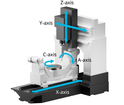

What is a 5-axis machining center?
This is a machining center to which 2 rotary axes have been added to the 3 linear axes, and is capable of performing multi-face machining with a single setup.
This is a machining center to which 2 rotary axes have been added to the 3 linear axes.

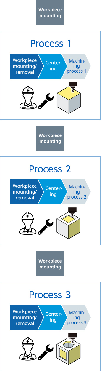

What are the merits of adopting a 5-axis machining center?

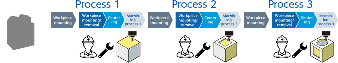

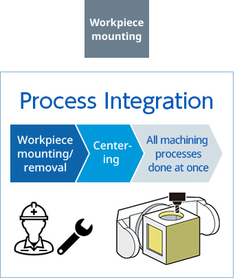

Multi-face machining can be performed by carrying out setup only once, which allows less jigs to be required. Also, high machining accuracy can be maintained by minimizing variations in accuracy that can occur when mounting workpieces.
3-axis machining
Setup is performed multiple times, leading to drops in machining accuracy.
3-axis machining 3-axis machining
5-axis machining
Setup is performed only a few times, allowing high machining accuracy to be maintained.
5-axis machining 5-axis machining

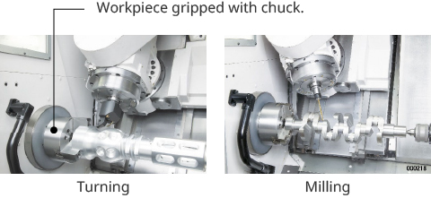

What processes can be integrated with a 5-axis machining center?
Milling, turning, gear cutting, grinding, and gauging processes can be integrated into a single machine (incl. options, also).
Milling
Milling
Turning
Turning
Gear cutting
Gear cutting
Grinding
Grinding
Gauging
Gauging

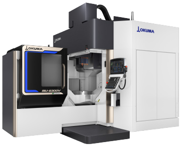

What is the difference between the MU-100V series and MU-1000V series?
The MU-100V series is capable of high-accuracy 5-axis machining in the same space as a 3-axis vertical machining center.
The MU-1000V series is capable of high-accuracy, high-efficiency simultaneous 5-axis machining. Process integration is also possible with turning.
MU-100V series
MU-100V series
5-axis machining in same minimal space as 3-axis vertical machining center.
Perfectly suited for step up to 5-axis machining.
MU-1000V series
MU-1000V series
High-accuracy, high-efficiency simultaneous 5-axis machining.
Turning (option) can also be integrated, making it perfect for improving 5-axis machining productivity.

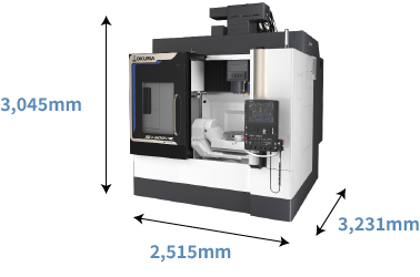

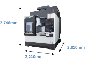

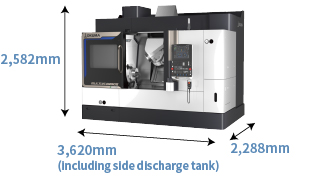

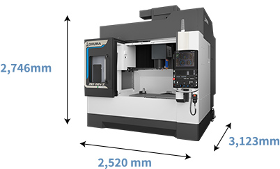

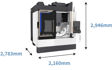

I'm worried about whether a 5-axis machining center will fit in my factory.
The MU-100V series can be installed in the same space as a 3-axis vertical machining center.

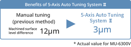

5-Axis Auto Tuning SystemⅡ
  • High accuracy maintained by compensating axis position and tilt error with simple operation.
  • Troublesome manual tuning work reduced.
Benefits of 5-Axis Auto Tuning SystemⅡ

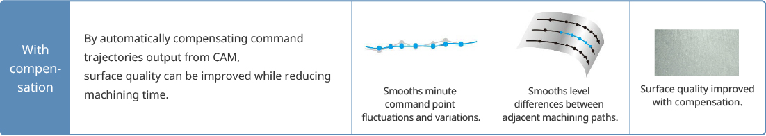

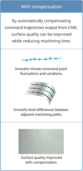

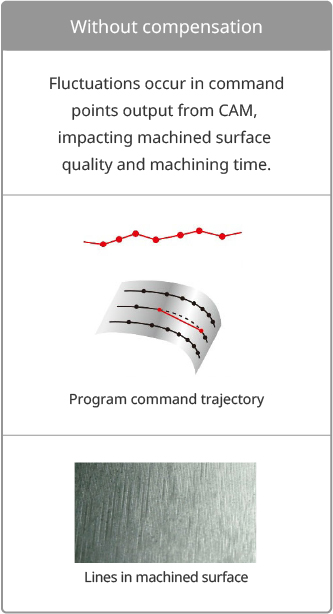

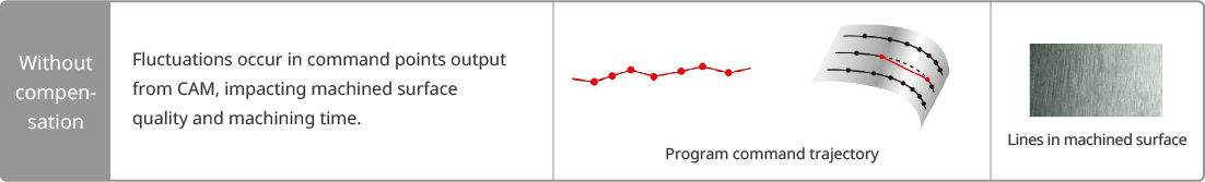

I want to machine dies/molds and free-form surfaces with higher quality.
By automatically compensating command trajectories output from CAM, surface quality can be improved while reducing machining time.

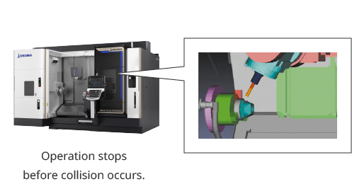

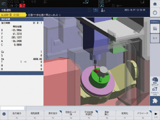

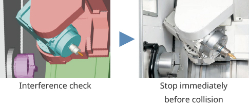

The complex structure of 5-axis machining centers makes me worry about collisions occurring during machine operation.
The Collision Avoidance System allows operators to operate machines without having to worry about collisions, and to focus on machining with peace of mind.
Automatic operation
NC program is read in advance to check for collisions.
Machine stops before collision occurs.
Manual operation
Operation is stopped immediately before collision even when performing manual operation
during setup work.

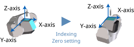

It looks difficult to create machining programs for 5-axis machining centers.
Programs for indexed machining can be created easily interactively.
Interactive programming
Index the machining surface, and specify zero setting interactively with ease.
After setting, interactive programming is possible with same feel as 3-axis machine.

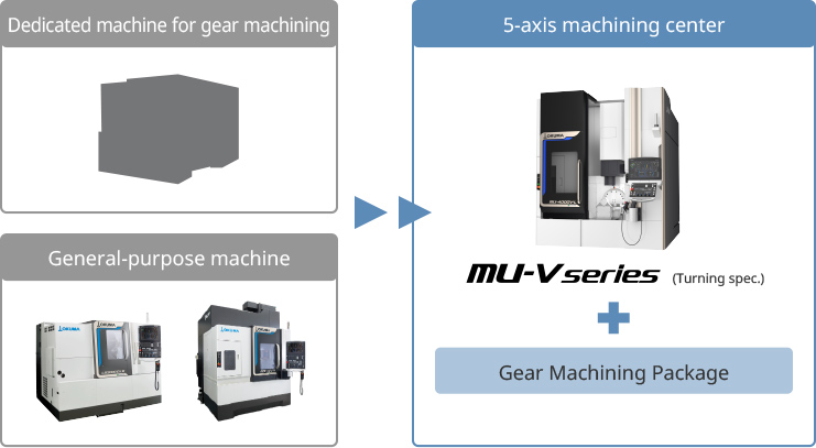

I want to integrate a gear machining process.
The high-accuracy gear machining process is integrated easily with 5-axis machining centers.
By entering basic information and dimensions of gear component, program output can be done.

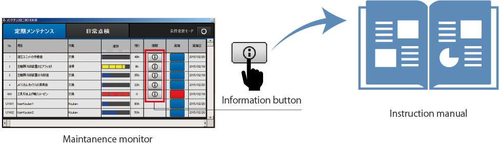

There are many maintenance items, and I forget some unintentionally.
Items requiring maintenance are all managed at the Maintenance Monitor.
Operators are notified of when they should perform inspection.
Daily pre-work inspection and periodic inspection items, and inspection timing guides are displayed.
By touching the information button, an instruction manual for maintenance items is displayed.
Items requiring maintenance are all managed at the Maintenance Monitor. Operators are notified of when they should perform inspection.

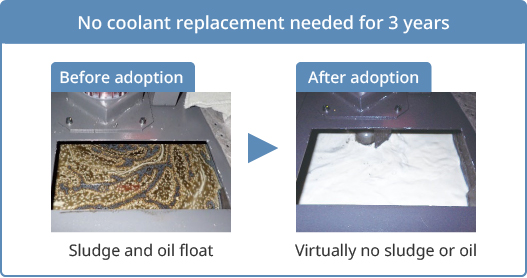

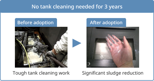

Sludge builds up in the coolant tank, and cleaning it takes a lot of time.
With a sludgeless tank, sludge does not build up, allowing cleaning work to be significantly reduced.
Sludgeless tank sludge removal rate: 99%
* All values achieved at OKUMA.

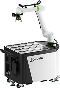

Mobile collaborative robot
robot
Pallet transfer systems
Multi-pallet APC flat-placing type
Tower APC
Tower APC
AWC
AWC
* Mainly for □400 mm pallets or smaller.
I have no experience of robot operation.
Robot operation and machining startup with a robot cell can be performed easily without any expertise.
Automated system capable of easily operating robot by setting parameters according to guidance
Mobile Collaborative Robot
Immediate automation of workpiece loading/unloading

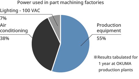

I want to reduce power consumption and CO2 emissions, but don't know where to start.
Most power used in part machining factories is consumed by production equipment (machines).
Let's reduce power consumption by understanding how much power production equipment is actually using.

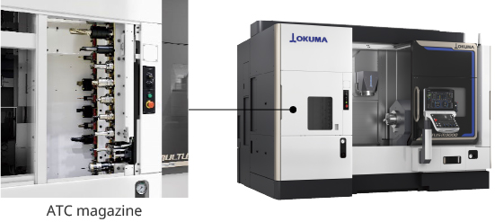

What is a multitasking machine?
A multitasking machine is a machine tool equipped with an auto tool changer (ATC), and is capable of machining processes such as turning and milling.

A diverse range of workpieces can be machined using many tools.
Further promotion of process integration
Turning
Turning
Milling
Milling
Gear cutting (option)
Grinding (option)
Grinding (option)
Gauging (option)
Gauging (option)

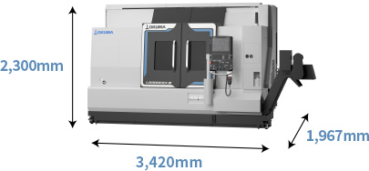

I'm worried about whether a multitasking machine will fit in my factory.
Our multitasking machines can be installed with the same machine height as lathes and machining centers.
Multiple processes can be integrated into a single machine for space saving.
Multitasking machine
W spec DBC 750
MULTUS B250Ⅱ
Lathe
MYW spec DBC 800
LB3000 EX Ⅲ
Vertical machining center
MB-46VⅡ

The complex structure of multitasking machines makes me worry about collisions occurring during machine operation.
Automatic operation
Manual operation
Operation is stopped immediately before collision even when performing manual operation during setup work.

Mobile Collaborative Robot OMR series
Compact size that allows operator to carry out work without retracting robot.
