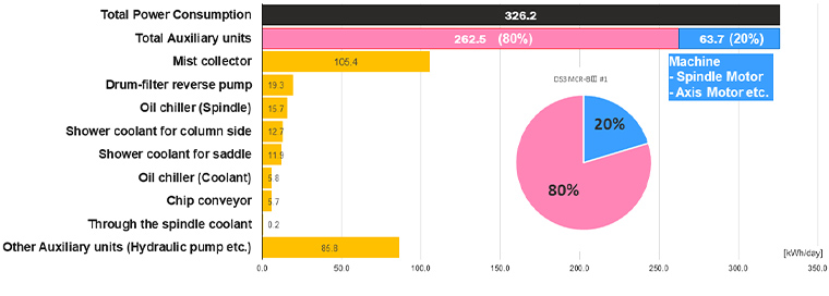

ECO Idling Stop
Ensure accuracy and actively turn off unnecessary peripherals
All auxiliary equipment when not needed (most of factory power consumption), can be turned off.
The ECO Idling Stop button enables diligent idle stop operations even during machining and maintenance work.
The cooling system necessary for maintaining accuracy uses Thermo-Friendly Concept technology, and the machine itself decides when to cool and stop idling while maintaining high accuracy.
With ECO suite plus, the machine automatically detects the operating status, eliminating the need to push buttons while reducing carbon dioxide emission as much as possible without operator awareness.

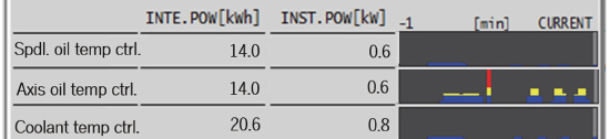

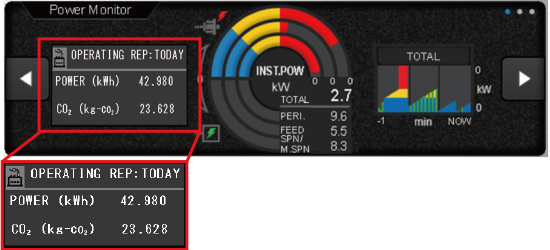

ECO Power Monitor
Evaluating energy savings and analyzing areas of reduced energy
Making it possible for the OSP control to analyze the operating status of each device.

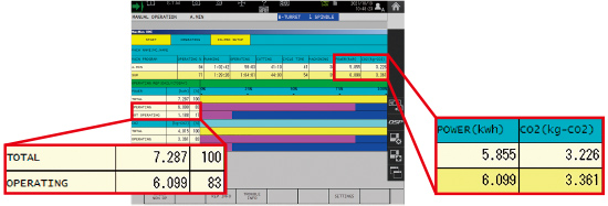

① Check carbon dioxide emissions on the spot
With ECO suite plus, you can also check the power consumption of each device.
② Simultaneously records operating status and carbon dioxide emissions
With ECO suite plus, recording carbon dioxide emissions for each device, and data output is possible.
③ Analyze carbon dioxide emissions and improve machine tool operation
With ECO suite plus, not only the display on the machine but data analysis for each device is also possible on a PC, to see a more detailed carbon dioxide emission analysis.
MCR-BⅢ at DS3 Energy Consumption
