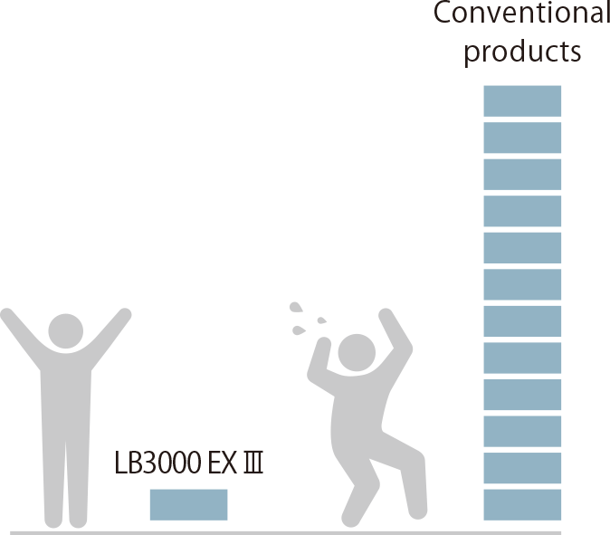

The LB3000 EX Ⅲ CNC lathe achieved a dimensional change of ø5 µm over time (8°C room temp change). This lathe achieves outstanding dimensional stability even during runs and environmental temperature changes in the factory.

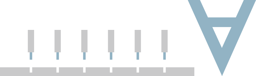

With thermal deformation control of the table position, dimensional errors due to varying workpiece mounting positions are reduced. Machining dimensional accuracy improves even for applications with a multiple of parts mounted on the table.
