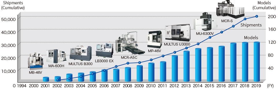

Thermo-Friendly Concept Equipped Machines and Cumulative Shipments

In approximately 20 years, the Thermo-Friendly Concept has become synonymous with Okuma’s “Only-One Technology,” and as of October 2019, it has been installed in 83 of 127 models, with shipments exceeding 50,000. Nevertheless, that is small compared to the number of machine tools throughout the world, and we will pursue even higher levels of Intelligent Technology by offering “faster, more accurate machining” for applications becoming increasingly sophisticated.
