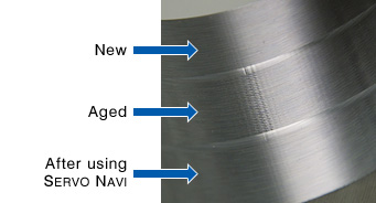

ERVONAVI SF recognizes the "aged deterioration" in machining accuracy resulting from long years of machine use, and restores the machined surface accuracy that is required. Surfaces with point-of-reverse motion lines noticeable from worn ball-screw and guideways can also be improved.
