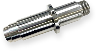

- Reducer component Motor shaft (with gear) (e-Axle)
e-AxleReducer component
Motor shaft
(with gear)
Component inserted into motor rotor
Material: SCM440H

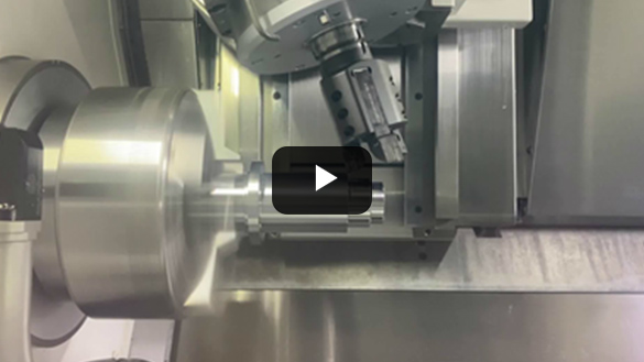

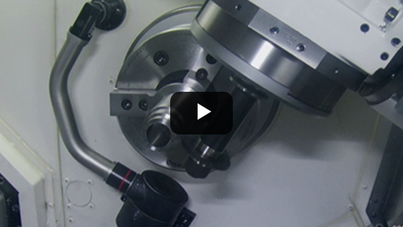

Keyway and gear cutting processes integrated and machined on one multitasking machine
- All processes, from keyway milling to gear cutting, are done on one machine
- The T-slot cutter enables the machining of T-slots without a slotter
- Easy gear cutting with Gear Machining Package
Program is automatically generated by simply inputting gear data
- Highly efficient turning that shortens cycle time
- Non-cutting time is reduced by using a multi-edge cutter that reduces the number of auto tool changes
- Highly efficient turning is achieved with B-axis turning that changes the cutting edge angle and suppresses tool friction
