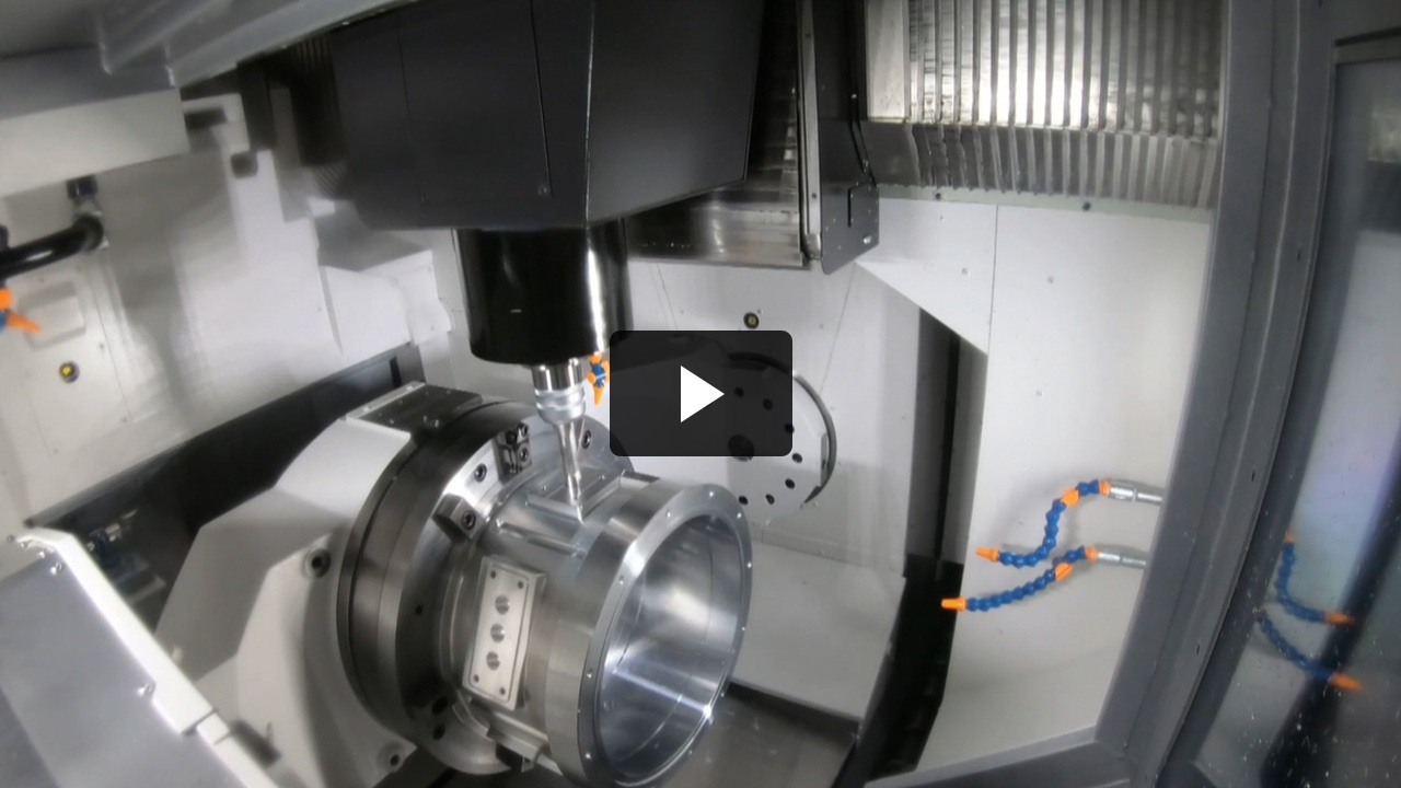

Multi-sided machining, turning, and workpiece washing processes are integrated into one machine
- The number of setups is reduced with process-intensive machining
- Processes from milling and turning to flat-tool grooving can be completed without chuck change
The trouble of setup change is saved, contributing to labor-saving - Tilted turning function enables perpendicularity and cylindricity of 5μm
It is possible to perform turning with high accuracy by indexing the A-axis at an arbitrary angle
- Setup time is also shortened with smooth cutting
- In-process workpiece washing is performed to smoothly wash the inside of the machine and workpieces
- Manual cleaning is reduced to speed up workpiece load/unload
