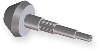

Drive pinion
Component that transmits torque to the ring gear and keeps rotation direction at a right-angle (for FR/4WD vehicles)
Material: SCM418H

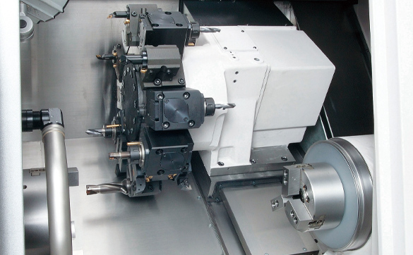

Machining is completed without chuck change by using a hydraulic quill tailstock and face driver
- Even tapered workpieces that are difficult to chuck can be machined in a stable manner
- The face driver and hydraulic quill tailstock secure workpieces firmly, enabling machining to be completed without chuck change
- Stable accuracy is secured with two-center support machining
Provide various proposals
- A variety of specifications are offered to enable various types of machining
- Y-axis function: Versatile milling is possible with wide Y-axis travel range
- W-axis specs: Process-intensive machining for front and back side of workpiece can be done on one machine with sub spindle specification
- Steady rest: Stable machining of long workpieces
- In-process gauging: Automated measurement and compensation of workpiece dimensions using an in-process gauge
