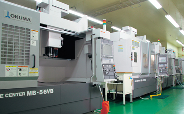

Most of the materials for optical semiconductor parts such as LEDs are difficult-to-cut materials, and machining requires micron-dimensional accuracy and strict surface roughness control.
- Issues
Machining centers with excellent dimensional stability
- We would like to achieve high-precision parts created with prototypes with high efficiency through mass production.
- Implementation
Installed the MB-46 and -56VA vertical machining centers with the Thermo-Friendly Concept as standard equipment.
- Effectiveness
Clears the required accuracy within the 5-micron tolerance.
Less chatter when machining difficult-to-cut materials- The required accuracy of a 5-micron tolerance was cleared, and compensation for thermal deformation became unnecessary.
- High-efficiency machining is now possible while suppressing chatter even on workpieces where the cutting speed cannot be reduced.
