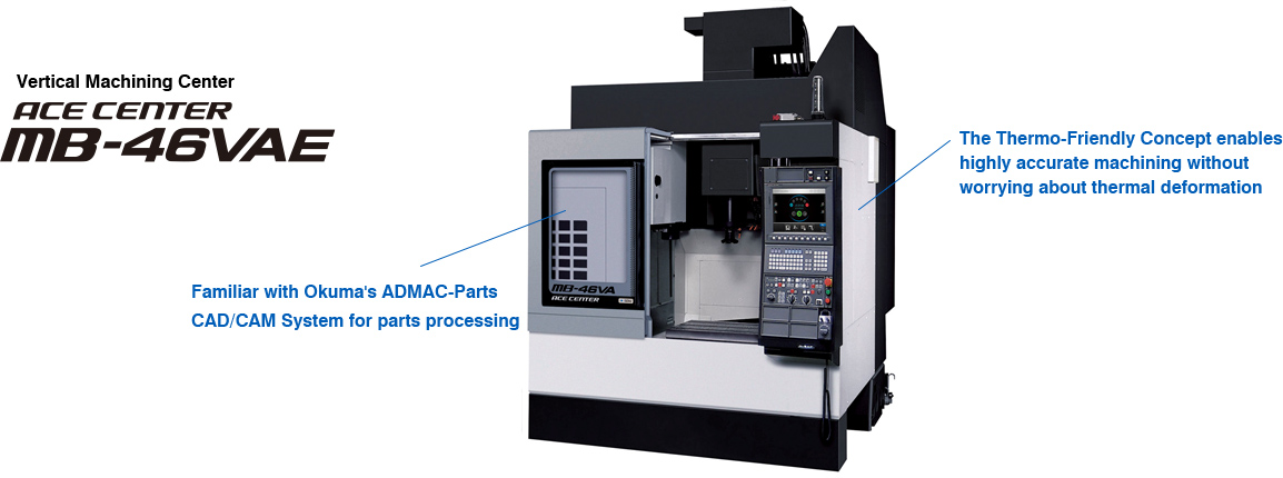

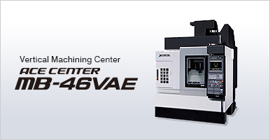

The decisive factor for installing the MB-46VAE.
Installing the MB-V with an emphasis on ADMAC-Parts compatibility and advice from Okuma's Digital Solution Section were successful in developing new methods.
We have been using the MX-45VA (MB-46V previous generation VMC) for more than 20 years, and we highly evaluate the unchanging rigidity and machining accuracy. We chose the MB-46VAE to expand our equipment capacity based on not just the price of the machine, but also with their careful explanations of the effectiveness the added value would produce. In addition, the voice from the shop floor saying that "our familiarity with ADMAC-Parts is important" was also a major factor in machine selection.
Even after installation, advice from Okuma's Digital Solution Section helped us develop new applications that achieve maximum machining accuracy and productivity improvement with minimum capital investment. This became an extremely valuable machine installation for our company.

The Thermo-Friendly Concept is effective for us here (located in Nagano) where it gets very cold, and recently it has also become quite hot in the summer, so we do rely on it. In 2018, we announced the "Easy 4 Method" for dramatically easier 4-axis machining, but the premise of this method is the performance of the MB-V which enables high-accuracy machining without worrying about thermal deformation. Also, the use of ADMAC-Parts, with its high degree of perfection as a CAD/CAM system for parts machining is amazingly effective. It is no exaggeration to say that this is a new engineering process born by making full use of Okuma's technology.
