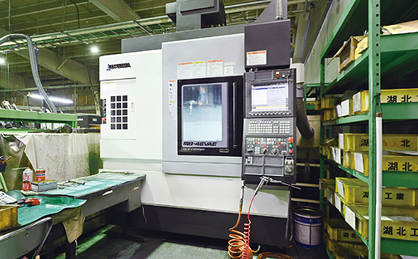

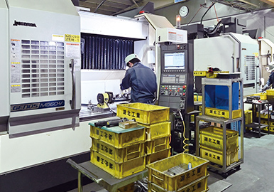

The MB-46VAE is also popular with operators because it is quiet and can be managed stress-free.

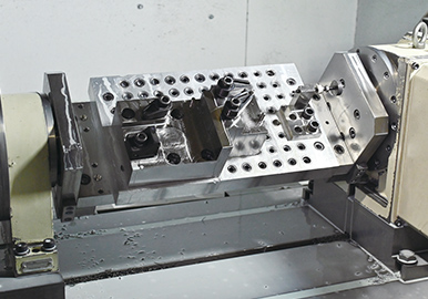

It is effective in machining cast parts with complicated shapes and from many different angles.

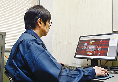

From fixture production to process design, ADMAC-Parts is an essential force for our company.

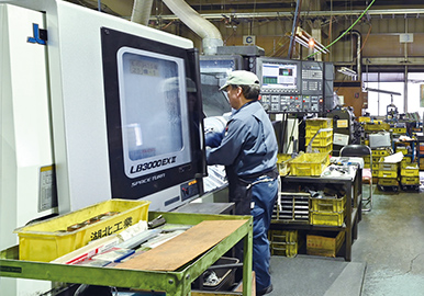

We have many Okuma NC lathes and machining centers.
