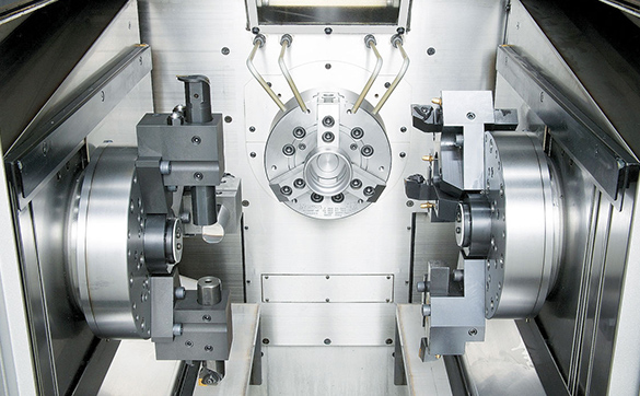

Improve productivity of collar-shaped workpieces with simultaneous machining using left and right turret
- Simultaneous machining with two turrets to improve productivity
- Turrets with superb access and excellent workability
- Simultaneously machining the inner and outer diameters of a workpiece with two turrets to shorten cycle time

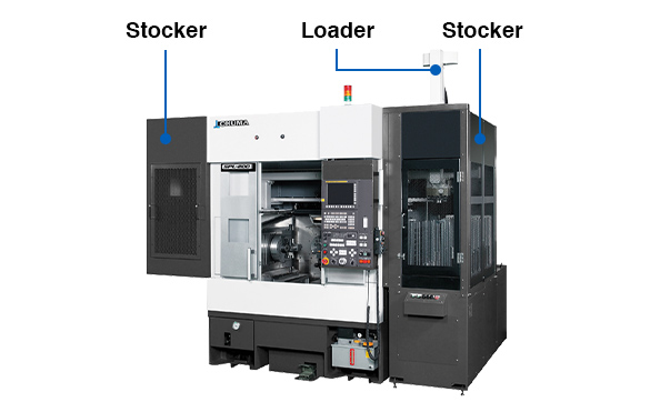

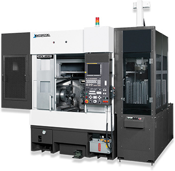

- Automation with a loader to improve efficiency
- Loader directly integrated into structure of machine
- Load/unload and transportation of workpieces can be performed within a small space, shortening the takt time
