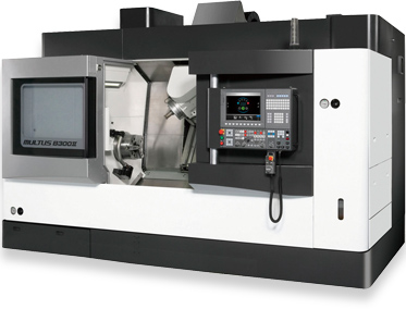

Geometric accuracy is ensured with one-chucking machining using a multitasking machine

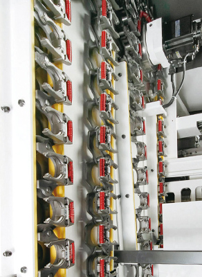

- Process-intensive machining is made possible even for workpieces that require a large number of tools by using a multi-tasking machine equipped with ATC
- Workpieces that are difficult to produce on a single lathe
due to the lack of tool capacity, can be machined without
chuck change using a multitasking machine equipped
with ATC
Reduces tool change time and workpiece load/unload time

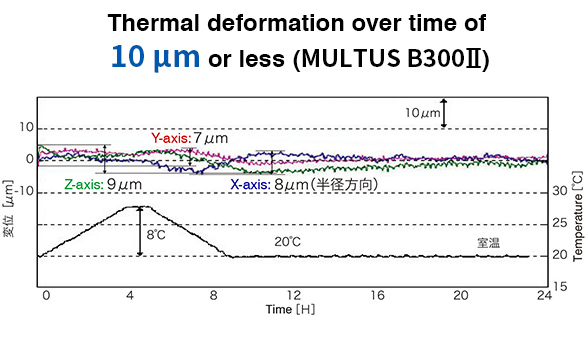

- Stable machining accuracy with the Thermo-Friendly Concept
- High accuracy stability is achieved even without special cooling equipment or excessive air conditioning control
