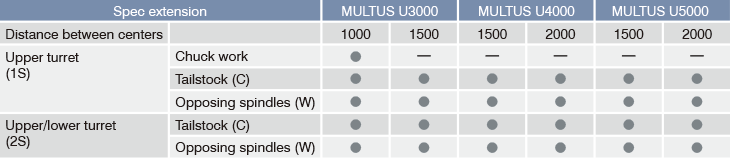

Item Unit MULTUS U3000 MULTUS U4000 MULTUS U5000
Standard chuck size in 8 10 15
Max machinig dia ømm (øin) 650 (25.59) 650 (25.59) 650 (25.59)
Max work length mm (in) 1,000, 1,500 (39.37, 59.06) 1,500, 2,000 (59.06, 78.74) 1,500, 2,000, 3,000
(59.06, 78.74, 118.11)
Spindle speed min-1 5,000 4,200 3,000
Tool storage tools 40 40 40
Motor kW (hp) 22/15 (30 min/cont) (30/20) 22/15 (30 min/cont) (30/20) 37/30 (30 min/cont) (50/40)
Machine size
(W × D × H)
mm (in) 4,925 × 2,995 × 2,955
(193.90 × 117.91 × 116.34)
5,425 × 2,995 × 2,955
(213.58 × 117.91 × 116.34)
6,175 × 2,995 × 2,955
(243.11 × 117.91 × 116.34)
5,530 × 2,995 × 2,955
(217.72 × 117.91 × 116.34)
6,280 × 2,995 × 2,955
(247.24 × 117.91 × 116.34)
7,935 × 2,995 × 3,090
(312.40 × 117.91 × 121.65)
Spec extension W, 2S, 2SW W, 2S, 2SW W, 2S, 2SW
W: Opposing spinde, 2S: 2 saddle
