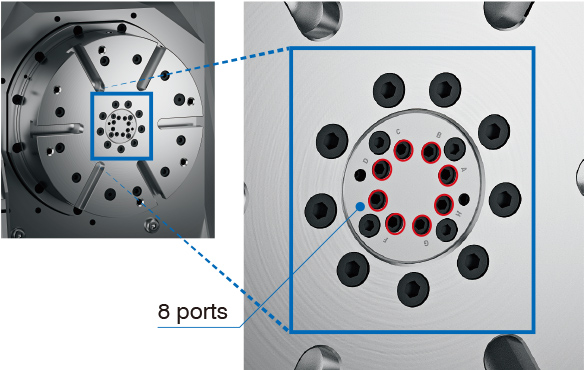

8 ports (hydraulic and pneumatic)
Equipped with eight fixture ports for supplying hydraulic and pneumatic pressure as standard specification. Enables flexible fixture compatibility and automatic attachment/detachment of various-shaped workpieces.

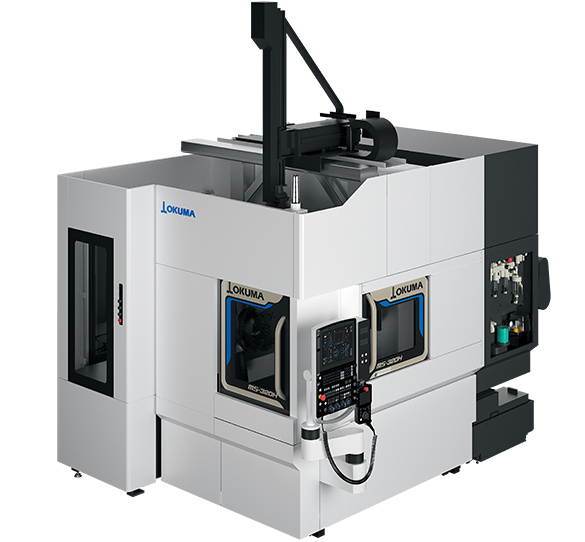

Machining cell designed to enhance productivity in mass production machining
Loader
Electric ceiling shutter shortens loader line takt time
The electric ceiling shutter, which opens and closes as the loader enters, enables precise monitoring of the shutter’s position, eliminating unnecessary movements. Additionally, it operates smoothly without shocks during opening and closing, achieving both high speed and reliability.

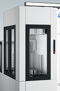

Stocker with high visibility
The 10-station work table features large acrylic windows, allowing the quantity of workpieces and finished products to be checked at a glance. This design helps in preventing machining stoppages caused by insufficient workpiece preparation.

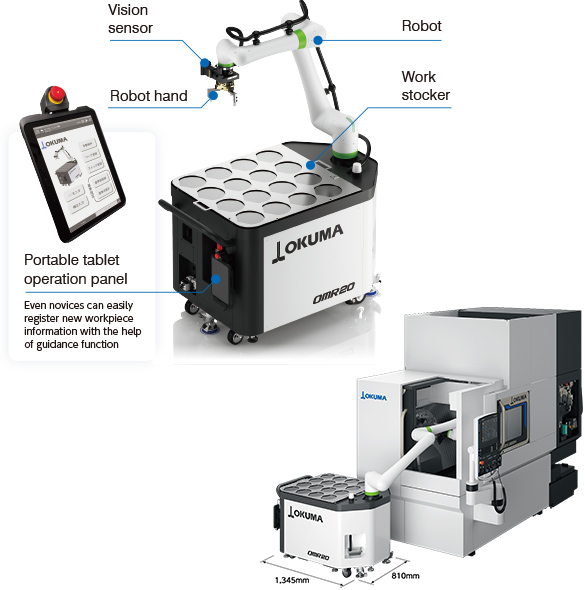

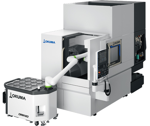

Mobile collaborative robot OMR series
Easy and compact automation
The mobile Collaborative Robot, which automates the loading and unloading of workpieces, achieves the automation of high-mix, low-volume production. With no need for safety fences, the robot can be moved freely within the factory, enabling flexible automation according to busy conditions. Machine switching is completed in just 4.5 minutes, significantly reducing start-up time. Moreover, no teaching or programming is required, allowing for easy operation of the robot without the need for specialized knowledge or skills. It can be installed within the operator’s workspace of a single machine, enabling compact automation.

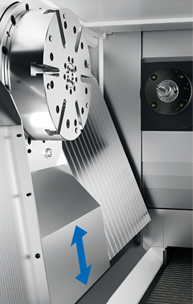

Innovative machine structure to prevent chip accumulation in the machine

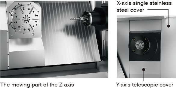

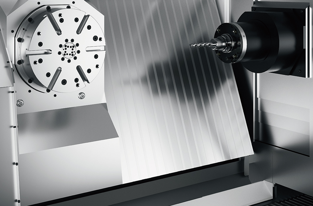

In-machine cover structure to prevent chips from accumulating in the machine
The slope angle of the stainless steel machine covers around and beneath the table has been increased (up to a maximum of 81°) to prevent chip accumulation.
The moving part of the Z-axis has been designed to eliminate any areas where chips could get trapped. Also, the single stainless steel cover design of the X-axis cover and a flat Y-axis telescopic cover with minimal unevenness prevents chip accumulation.

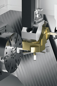

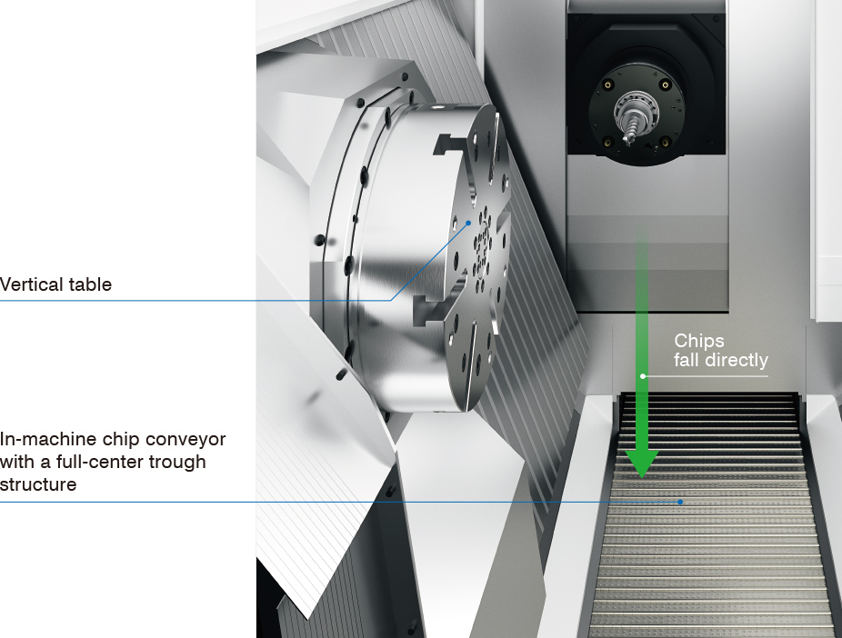

Full-center trough that collects chips across the entire machining chamber area, and a vertical surface table
The full-center trough structure, which enables chip discharge from the entire machining area, significantly enhances chip disposal capacity. By positioning the table vertically, chips fall directly on the in-machine chip conveyor located beneath the machining point and are discharged outside the machine, preventing accumulation on the workpiece or table. This ensures stable, long-term continuous machining without concerns about chip accumulation.

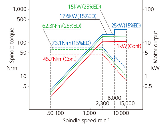

Equipped with a powerful No. 40 spindle as standard, capable of machining steel parts with ease
The machine features a powerful No. 40 spindle, standard-equipped to effortlessly machine steel parts, delivering high-power cutting performance despite its compact size.
| Spindle speed |
15,000min-1 |
| Max output |
25/11 kW (15%ED/Cont) |
| Max torque |
73.1N・m(15%ED) |

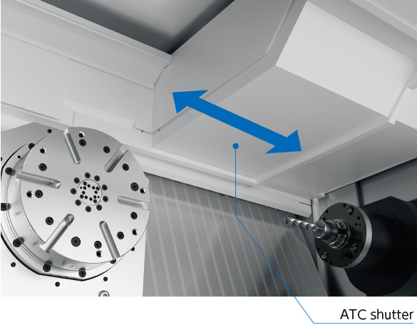

An ATC electric shutter, which shortens non-cutting time, is installed as standard
The ATC shutter opening/closing time is shortened
Tool change time is reduced through the synchronous control of the shutter and the tool change arm
The standard-equipped ATC electric shutter allows precise positioning of the shutter, enabling synchronous control with the tool change arm to eliminate wasted movements and reduce tool change time. Furthermore, it eliminates issues caused by shock during shutter operation, which were common with air-driven types, contributing to more stable machine performance.
