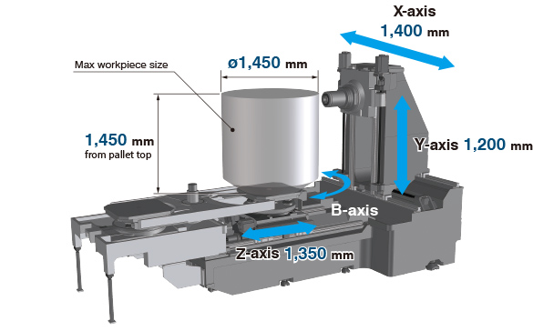

Higher floor space productivity with larger work envelope
Optimal travels for the large parts applications
With longer X-, Y-, and Z-axis travels, a wider range of applications can be handled.
Larger work envelope
X-axis travel: 1,400 mm (longer than previous machine)
Y-axis travel: 1,200 mm (longer than previous machine)
Z-axis travel: 1,350 mm (longer than previous machine)
Load capacity
3,000 kg (option) (more than previous machine)
Max workpiece size
ø1,450 × 1,450mm
Max tool length
800 mm (option)
Higher floor space productivity with larger work envelope X-axis travel:1,400mm Y-axis travel:1,200mm Z-axis travel:1,350mm

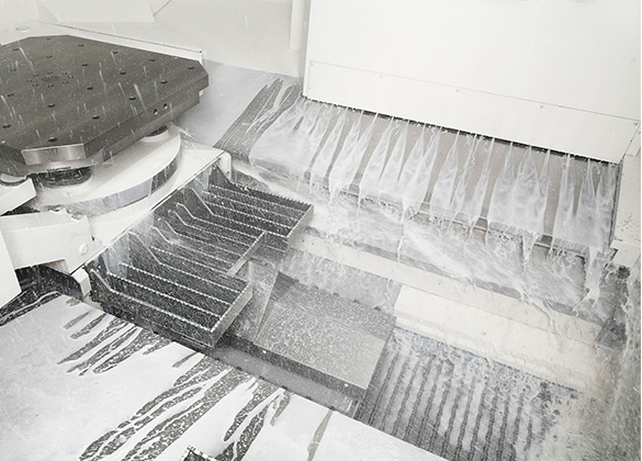

Chip discharge that maximizes uptime
With simple workspace covering and reinforced coolant applications, efficient chip discharge and long-run machining possible
Just Z-axis travel single cover and a smooth X-, Y-axis telescopic covers suppress chip accumulation.
Moreover, in dry machining without coolant, washing only the lower workspace area with coolant is possible.
In-machine washing prevents likely areas of chip accumulation, by cleaning away chips to maintain long-run production runs.
Chip discharge and workspace area designed to prevent chip accumulation
  • Stronger workspace lower area with large-volume coolant wash and hinge conveyor smoothly removes accumulated chips out of the machine.

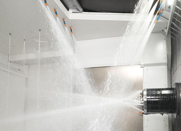

    Chip discharge
  • From the upper area of the workspace, a shower coolant system (option) and coolant from the X-, Y-axis telescopic covers suppress chip accumulation.
    Workspace area designed

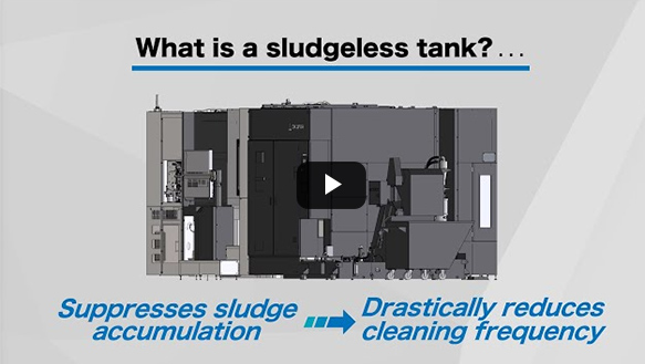

"Sludgeless Tank" enhances stable operations (recommended option)
Suppresses sludge accumulation in the coolant tank Dramatically reducing troublesome tank cleaning work
It is important to remove impurities (sludge) contained in the coolant for stable operation of the machine, and coolant tank cleaning is indispensable. The Sludgeless Tank (recommended option) effectively removes sludge and reduces coolant contaminants. By suppressing sludge accumulation in the tank, the frequency of troublesome tank cleaning can also be drastically reduced, enabling stable operations over long runs.
Coolant sludge removal, less environmental impact when disposing coolant

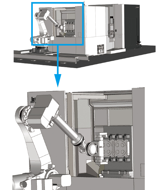

Auto Setup Station Pallet Rotate (option)
This feature automatically rotates the setup station pallet in 90° increments by stepping on the foot switch.
Operator efficiency has been improved, and robotic part load/unload can be done from multiple fixtures.
Example of robotic automation

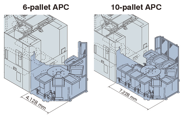

Flexible APC systems
Multi-pallet APCs allow the operator to single setup a large number of workpieces, and use the extra time available for other jobs. Setups at the end of the day for untended operations are also a benefit.
  • Multi-pallet APC connects to standard 2-pallet rotary-shuttle APC
  • Pallet change time is the same as in the standard APC
  • Can be adapted to match plant layout and type of production
6-pallet APC、10-pallet APC
