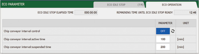

ECO Operation (option)
Peripheral equipment runs only when needed
By using only the required peripherals (chip conveyor, mist collector), energy-saving operations that also maintain high productivity are possible.
ECO suite plus enables more detailed tuning of operations to thoroughly support carbon dioxide emission reduction activities that do not reduce productivity.

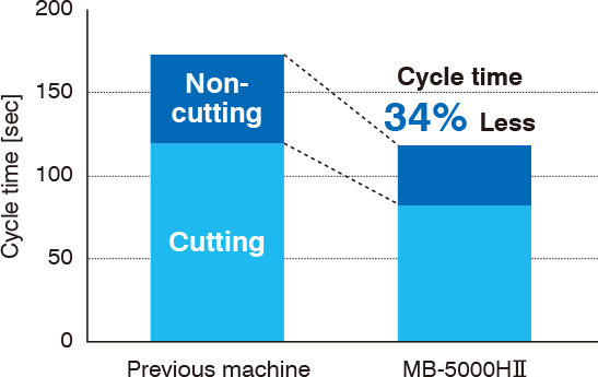

- 3Shortening cycle times

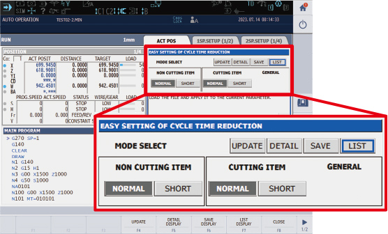

Cycle Time Reduction (easy setting)
Significantly shortens cycle times and reduces power consumption
Cycle times become much shorter by selecting the optimal parameter settings for the workpiece and machining operation all at once.
- [Measuring conditions]
- Sample part program used to drill and tap dozens of holes on three sides of an aluminum die casting.
